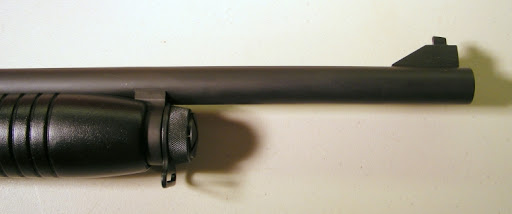

I am thinking about adding a flashlight to the front end of my Grizzly. The barrel is pretty long, so I thought I could add the light directly under the barrel, ahead of the mag tube. What do you guys think? Do I just get a clamp of some sort and hang a decent flashlight? Here's what I have to work with:
You could clamp a light under the barrel, and it would look like part of the mag tube.
The problems with that would be a) reaching the flashlight, unless you have long arms and can comfortably reach beyond the end of the forend. b) Access in control (tailcap) if the flashlight is inline with the tube.
You could mount the flashlight to the side (9 o'clock position) you would be able to press the tailcap with your thumb (beware recoil if you do this).
You could keep the flashlight under the barrel (6 o'clock position) and use a flashlight with a coiled pressure switch running back to the forend. The problem is that the cord could get caught in the forend and prevent the action from fully closing.
You'll have to figure out which compromises your willing to make and go from there.
