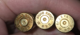

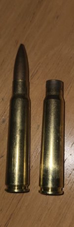

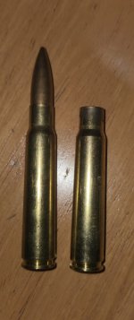

Hi, I thought this would be the best place to ask the experts. Factory S&B 7.5 swiss and 8mm mauser. Do these primers look bad or normal for factory s&b? No sticky bolt or other pressure signs. Would hlgunk in the chamber flattened a primer but not cause sticky bolt?

S&B brass has a straight wall primer pocket with little to no chamfer on the top, so not a lot of space for a primer to flow into. To me that looks normal.
when you typically use primers of a indication of pressure signs what happens is the primer flows and fills up the cup just because they are flat really has no bearing on there being a problem

I noticed a similar problem with S&B brass in 6.5 Creed and 7x64. Slow velocities and no other indication of high pressure so I just chalked it up to the brass/primer pocket shape.
Over sized brass will slam into the bolt face and flatten the crap out of primers when fired.

But what I said holds true, with factory ammo in a potentially borderline chamber for headspace, the cases grow into the bolt face and flatten the primers….. I actually saw this just the other day with some factory .264 Win Mag in a factory rifle with some generous headspace….
Yeah I am just making sure there is nothing obvious for S&B 8mm. No extractor wipe or other signs it just looks flat on both compared to say norma.
