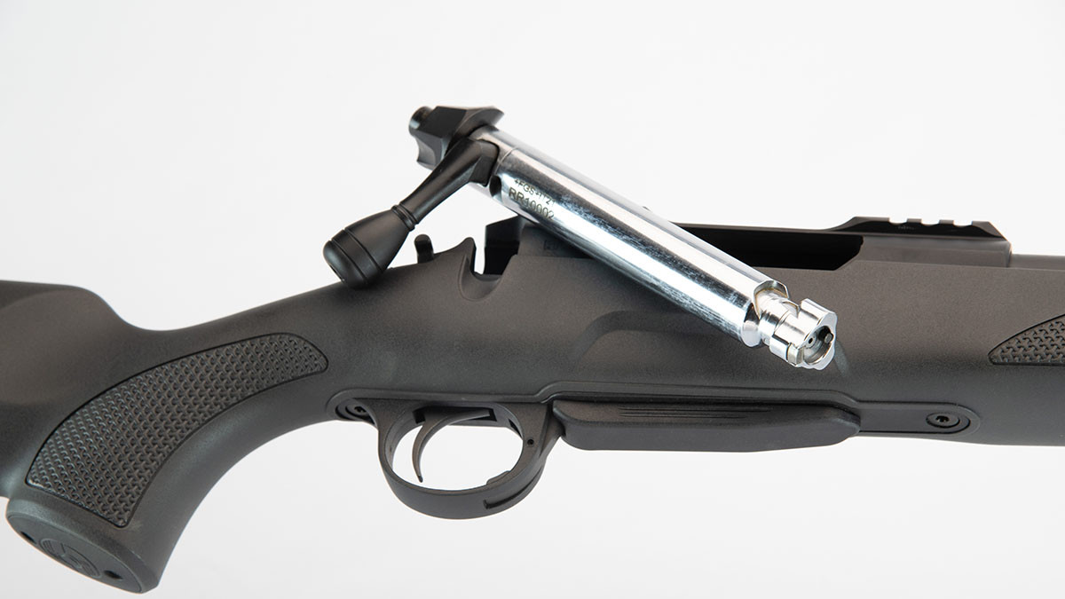

I have a Sabatti Rover almost brand new. and when i put more than one cartridge in the internal magazine, after the first fire, the floor plate drops and the rest of the cartridges fall out. the floor plate just drops open by itself after firing.
any suggestions on fixing this.
thank you..

IMG_20220613_2sssssssssssssssssssssssssssssss24928 (2).jpgIMG_20220613_230ssssssssssssssssssssss317 (2).jpg
IMG_20220613_230ssssssssssssssssssssss317 (2).jpgIMG_202206ssssssssssssssssssssssssssssss13_230307 (2).jpg
It looks like it's not quite fully seated, is there some plastic from the stock or something else interfering with the plate fully seating in the closed position?
The other possibility is the release lever is not fully engaged, there is a bit of a shadow in the first picture but is the fit on either side of the latch portion symmetrical with some clearenace so it's not contacting the trigger guard on the left side? It looks like the latch portion is a pretty tight fit where the lever engages.
attachment.php
Loosen the front action screw and see if the floor plate engages better. Its possible that the trigger guard assy is being bowed slightly when the screw is tight. If so, a thin washer placed under the trigger guard at the front screw would be a quick fix.
