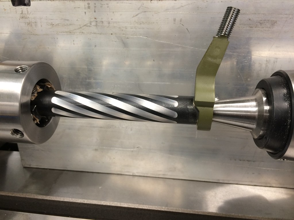

As mentioned by bdb.hunting I do bolt fluting.
As ATRS points out, it provides very little in the way of weight reduction and should realistically be considered an aesthetic procedure.
As ATRS further points out Remington bolts can be botched if the smith is a gorilla who flutes too deep, too close to the solder joint behind the bolt head.
However, I disagree to the structural integrity aspect. the pressure is contained by the locking lugs. period. If you don't mess with those you haven't altered the safety of the rifle. the bolt body does two things: center the locking lugs in the race way and house the firing pin.
The answer is, don't botch a fluting job... no different from not botching a threading job or chambering job or any other job.
I agree fluting a bolt is for looks only... and your work looks beautiful.
