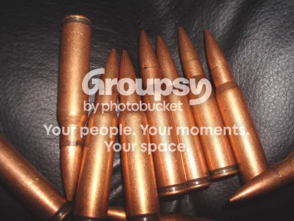

These casings are not Berdan primed type but why the copper looking cases?
Most likely copper washed steel cases. Probably Norinco, corrosive. Good shooting ammo.
Are you sure they're not Berdan primed? Most are.. And even if they arent, you cant reload steel cases anyway.

You nailed it right on Zz denis, I have the same ammo as in your pics. And after pulling one apart they are Berdan primed. So it looks like it's safe to go, but not the reloading part due to the steel casings, thanks guys.

Copper washed cases and projectiles is not uncommon with East-bloc steel cased, steel projectile ammo.
