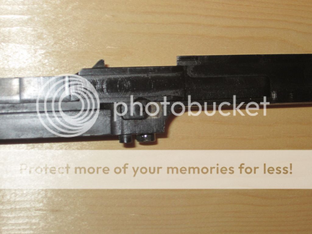

Also, when cleaning the receiver I noticed a broken part. On the left side, there seems to be a pin that goes through the receiver with a rectangular head. half of the head is broken and the piece is missing. Ill post an internet pic since I am away form my camera. If you look at the pic, right above where the magazine catch would be, there is a rectangular piece. Mine is broken. Was not there when I bought it so who knows when it broke. metal is dark so been like that for a while. What part is it? Is it critical to the safety of the firearm? looks like its not meant to be removed as the "footprint" of where it was is bear metal.
Just had a good look, it seems the pin is the bearing surface for the locking lug on the bolt. SO, with the broken head is this a problem?

Just did a bit of googling, the part that broke is called a locking shoulder. Like I mentioned the head of the part is broken however the actual load hearing art of the shoulder is still in tact.
My guess is that it had a fault and the stress of being pressed into the receiver probably cracked it and over time it broke off.
LeeEnfieldNo.4_mk1: Are you saying a small piece is broken off the end of the insert? Try to show it with a photo if you have time.

here is a pic.

OK, So I was thinking I should order a few different locking shoulders from numerich. And install the one that will provide the best head spacing.

No danger from what the pics illustrate - if the locking shoulder is loose or the headspace is questionable, that's a different story.
I am not too familiar with the FN49 but with my experience with the fn fal I would say there are a few red flags.. You should be able to mic the shoulder once it is out and match it up that way. Also, check the receiver around the locking shoulder recess and look for cracks. I would then find a gunsmith with a set of headspace gauges to check it out once put back together.
From Wayne Johnson's book, The FN-49 The Last Elegant Old-World Military Rifle.
You should be good to go, unless it starts to backs out.
