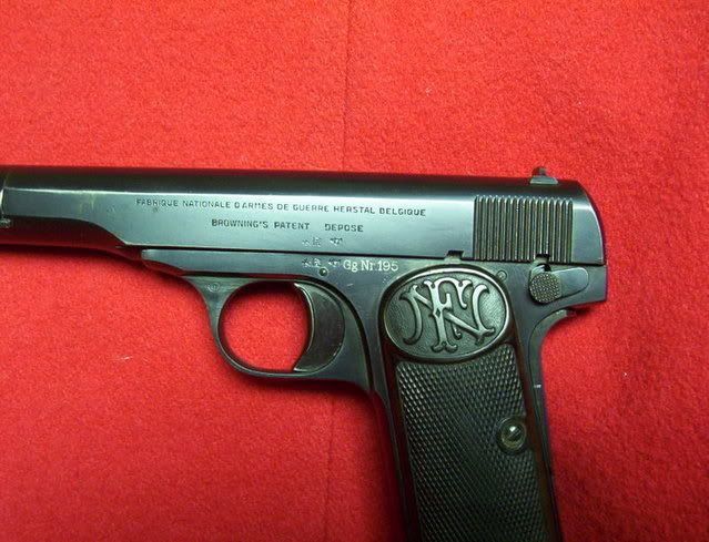

My apologies for the thread hijack, but info re; the markings on this 1910/22 (the "Gg Nr. 195") would be appreciated .....
The 1922 was made extensively for foreign contracts and serial numbers were according to the customer, not consecutive. Slides and other parts were apparently used out of sequence of manufacture, but the all capital letter roll stamping may help narrow the issue/assembly date the pistol.
Made after 1922 and before 1970, the proof marks could also help date the pistol because each inspector at the factory had his own, so the proof marks would add a second date range. Contract, inspector, and judging by the low serial number, probably made early in the contract so likely the first year.
Are there any other markings, on the top of the slide for example (Dutch military ones were marked with the Dutch crown and the letters of the reigning monarch) ... I don't know much about these, I'm a 1910 fan. Serial numbers don't help much unless you know which contract the pistol was made for. I have some information regarding Dutch pistols since I owned one and researched it a bit, but other members here may know what the Gg means.
