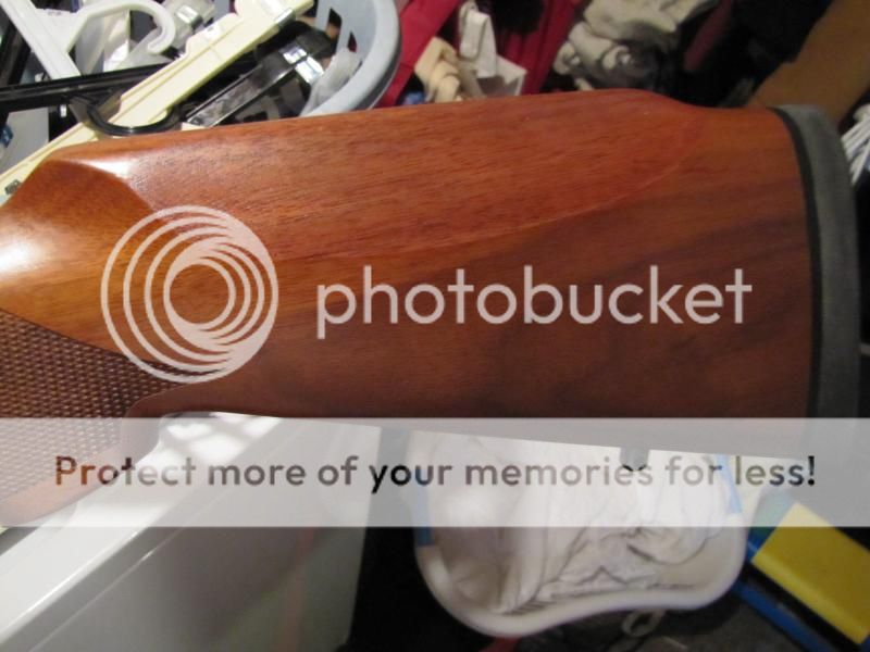

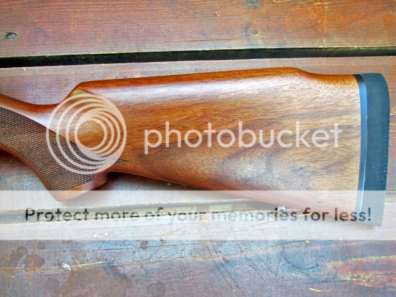

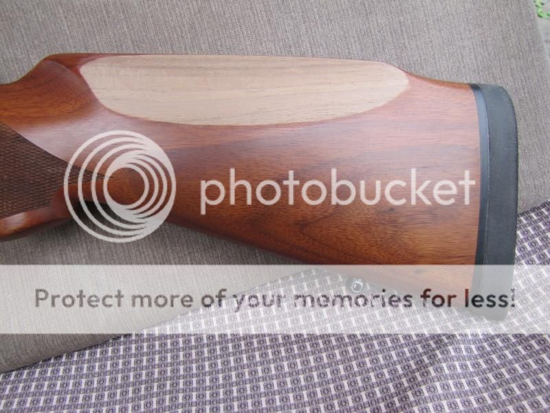

I got my courage up and performed the surgery an my Alaskans butt this week.
Overall turned out pretty nice and now comes up to my face correctly now. The stock looked more like ash than walnut. A couple coats of Minwax Sedona red stain made it closely match and used satin Varathane I had kicking around.
you just thinned it good idea i cut mine right off and thinned the stock below it. it looks pretty good shape wise. surprising how much difference a bit of thickness makes
Just returned from the range for a quick shoot to try it. Fits me perfectly and still mild even off the bench. Few more coats of Varathane at it should blend in better. It actually looks better in person than the photo's show. Now I just have to take an Elk with it.
