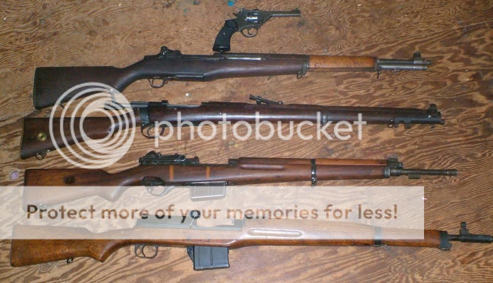

http://www.canadiangunnutz.com/forum/showthread.php?t=39345&highlight=.555
Here are some pictures, i also have a picture of my fn49 and hakim in one of my photo folders on this link as well
