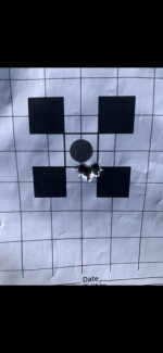

Thank you for reply. No rush take your time. I had 4 FNAR over the years and with one of them I found to be most accurate. The most accurate group I got from 4 bullets was .33inch at 100 yards. I didn't fired the 5th shot, so I can duplicate the load data. After that I never got a chance to explore further. I am not consistent with reloading to my expectations so I was looking for factory load . Data is listed below. I will try to find the target and will upload Pic if i found the target.
OAL 2.815
POWDER VARGET 43 GRAIN
BULLET 155ELD-M
BRASS HORNADY(BRAND NEW)
PRIMER CCI
4 SHOT IN .33 INCH
IF I FOUND THE TARGET I WILL POST OGIVE AS WELL. FROM MY FINDINGS HORNADY BRASS WAS LIMITING FACTOR. FEEL FREE TO ASK ME QUESTIONS IF YOU HAVE ANY. IF I TRIED AGAIN I WOULD GO WITH LAPUA BRASS. I AM 100% AGREE THAT 1/12 TWIST IS LIMITING FACTOR ON THIS RIFLE. FROM MY 2 CENT I HAVE FOUND FNAR IS MORE ACCURATE THAN BROWNING BAR. MOST OF THE FNAR I HAD OWN WERE CONSISTENT 1.5 INCH GROUP. THEY ARE BETTER IN ACCURACY THAN M14 ESPECIALLY WHEN FIRING FAST.
