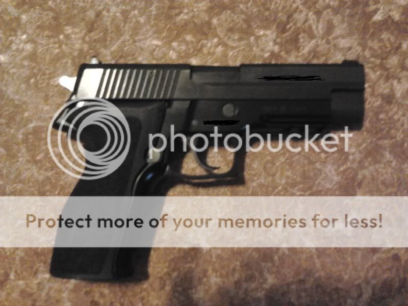

Hey guys,
A while back I posted a question if a Sig E2 grip could be installed on a Norc NP22. One board member replied, and said slight mods were needed. I didn't even have to mod mine, but he could have been using an older NP22 (I just got mine). You do need to purchase a new style hammer spring - the Norc is based on an older Sig design, and the hammer spring is too long. I purchased a 17 LB Wolff Hammer Spring. I have smaller hands, and I must say, the Sig now fits me properly - although a trip to the range will confirm this for certain. Another side benefit was that the new Wolf Spring did improve the SA trigger pull, it is noticeably lighter. It did nothing to improve the DA trigger pull whatsoever. Sorry about the low quality pic - I took a quick one with my phone.
Looks very good. I have seen the E2 grips up close inspecting a Sig from another member from my range and I must say I am tempted to do the same to my NP 22.
You wouldn't regret it. They fit great, and the original grips on the Norc are terrible (the only thing on the gun that is). I bought a set of old school Pachmayrs originally, but they were way too big for my hand. When I got a chance to handle an E2 Sig I figured they were worth the money. The whole thing cost me $95 with shipping, including the Wolff Spring.
Yeah, I'm rocking the Pachmayrs and the Wolff spring for now. I am very tempted...
maybe after I pay off a few bills.
If you get a chance, post some more pics.
