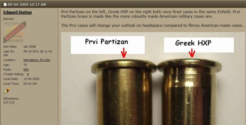

Prvi Partizan cases are .010 thicker and heavier in the base web area than ANY other brand of .303 case.
Fired Prvi and HXP cases below. Prvi Partizan on the left, Greek HXP on the right both once fired cases in the same Enfield. Prvi Partizan brass is made like the more robustly made American military cases are.
The Prvi cases will change your outlook on headspace compared to flimsy American made cases.

Rick, do you mind if I use my own photo that I took with my camera of my fired cases. You didn't measure the Prvi Partizan rim thickness, the base diameter or the case wall thickness.
So why don't you try getting your own information and photos. I do not want anyone thinking I was copying your work when I post "MY" photos here. You even copied word for word what I said in another posting.
Below another of my photos measuring rim thickness of a Winchester and Prvi Partizan case in my original posting.
So again Rick I would like to use my photos and information here and not let people think you did all the work measuring cases.
Your picture? That picture is from a post over a decade ago, from a username Ed Norton on the Milsurps forum... A guy now banned BTW because he was such a quarrelsome, easily offended #### that it was easier to ban him than put up with his endless shyte disturbing. Here ya' go, Sunshine; same picture and the post it was included in:

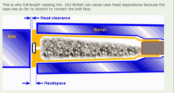

But NOT posted by the notorious and now banned Ed Norton NOR bigedp51. No, it looks like a carbon copy of a lengthy article on Lee Enfield headspace written by username parashooter. Are you parashooter as well over there, bigedp51?
https://www.milsurps.com/content.php?r=296-Headspace-101-for-.303-s
Hmmmmmm... except for your text above the graphic, looks like a plain ol' cut 'n paste job of parashooter's post. BTW, I'm username Rick here, Milsurps... pretty much all the forums I visit.

And yes I copied Parashooters animated gif image of the .303 cartridge being fired. And this was because he was telling everyone to lube their cases to fire form them. And and I was telling them to use the o-ring method because lubing your cases increases can increase bolt thrust and can increase the Enfield rifles headspace.
Below from a 1946 Enfield book that was in my Enfield manual sticky at Gunboards that "WAS" stuffed full of Enfield information given away free.
This forced Parashooter to change from greasing cases to wrapping weed wacker cord around the case rim. And this was because I was telling everyone to use the o-ring method and "NOT" lube their cases. So how many of you use weed wacker cord to fire form your cases or lube your cases to fire form them and double your bolt thrust.
Below Parashooters animated gif image for his "Headspace 101".
And the two images below I modified from Parashooters Image to show how to use the o-ring method and letting the case headspace on its shoulder.
And remember Parashooter did not make these images below, and I modified them because we were at war over lubing cases or using o-rings.
So Rick I do not feel bad about using Parashooters image because I was using it to explain bolt thrust and how it can increase the Enfield rifles headspace.

The Enfield rifle was proof tested with two proof cartridges and if the headspace increased .003 or more the rifle failed proof testing. And Parashooter was telling everyone to lube their cases to fire form them. So I had no problem using his image and proving him wrong.
