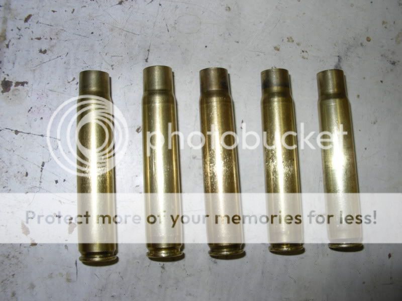

Here's the RCBS die for necking 30 cal to 400. You can also use a .375 neck expander, but it does not give nearly the false shoulder that a 400 does.
Lube the inside of the standard 30-06 neck well, bottom case, and a single pas through the die gets you the case in the middle of this picture.
The next step is to lube the straight case for sizing. The FL sizing die is then set so the bolt will just barely close on the sized brass. This is accomplished by by turning the die down a bit at a time and checking a single case until the desired forming is reached. The top case has been formed to just barely close on my Husqvarna.
The lock ring is then set to keep the die at that position in the press, and all the brass is sized the same.
From there, it's just loading as normal. Do not use reduced loads for this step. Accuracy will be essentially no different from loads using fireformed cases. I have actually hunted with ammo that has not been fireformed on a number of occasions.
