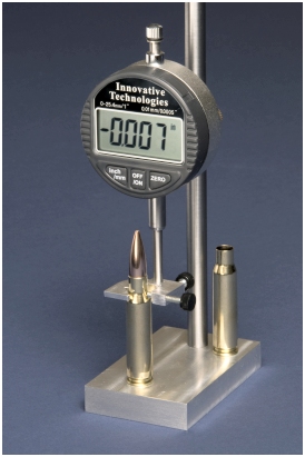

You cannot do this without measuring , SAAMI spec for .308 can be 10 thou between go and nogo, if ur chamber is cut to 1.635 (SAAMI headspace min =1.630, max 1.634) and ur bump die is cut to 1.631 when u resize snug to the shell holder u will bump the shoulder 3-4 thou. The tool at the link below is excellent and can be used on nearly any case to assess headspace changes relative to a fired case

How to measuring chamber clearance more accurately.
Whenever you resize a case, it is far better to start by knowing the "exact" size of YOUR particular chamber. There is very little benefit to comparing your handloads to a gauge, even though it "might" resemble your chamber. The Digital Headspace Gauge calibrates to the size of YOUR particular chamber. Then, you can measure one of your handloads, and it displays the exact shoulder clearance that YOUR handloads have in YOUR particular chamber.
A full length die adjusted "accurately" is always your best bet. Other resizing dies are rarely (if ever) needed. The Digital Headspace Gauge also measures the bullet jump to the rifling. It shows everything you need to know about how things actually fit inside your chamber.

Also a digital vernier caliper or Larry Willis's Innovative digital gauge is VERY easy to read and use, especially when you have chronology gifted eyesight. (and braille gauges are so hard to find) Yes the "GOLDEN" years are wonderful, BUT they are more challenging.
