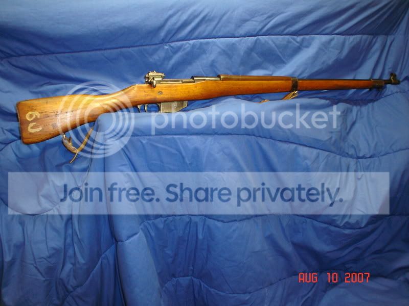

Here's pic of one of my original military MKIII Ross showing the military rear-sight lying flat. Could be raised and fully adjustable unlike the M-10 .280 factory sporter "Porter peep".
Pics would help here, but assuming your Grandfather's Ross is a sporterized MKIII Ross (to be correct), it likely has it's original adjustable rear sight. The "Porter peep-sight" was specific only to the M-10 .280 (being correct again). The model 1910R was a factory sporter available in .303, but it came with a Winchester buckhorn rear sight.

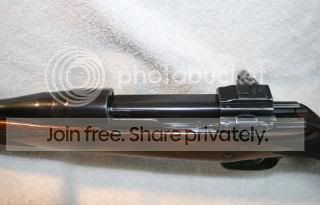

The sight I'm curious about is a small, simple, folding peep, mounted on the bridge, and non adjustable for windage or for elevation.
Unfortunately, I don't own a digital camera.
PP,
Most M-10 came from the factory with the filler block and the Porter sight was a 4.00 $ option. Also, the Ross Rifle Co. was willing, at extra cost, to install at the factory almost anything one would like to have.
