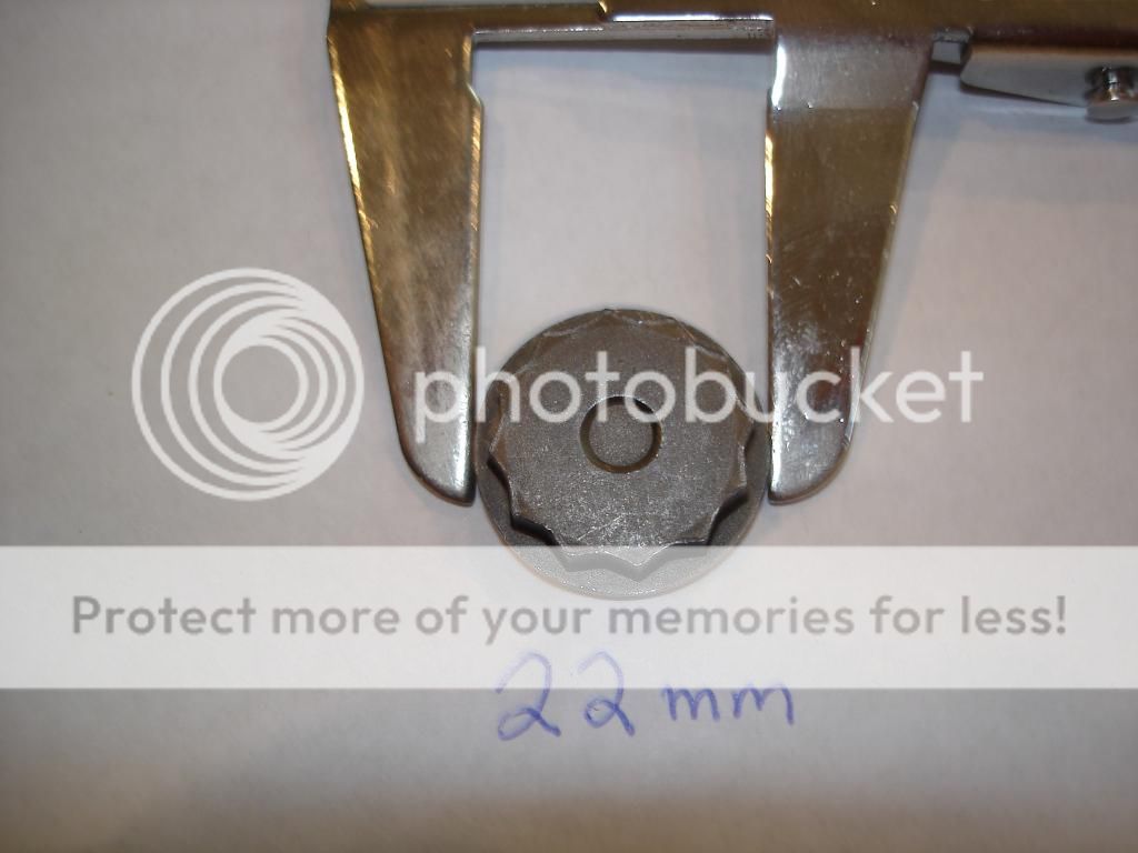

It has a shoulder, overall width 22mm:

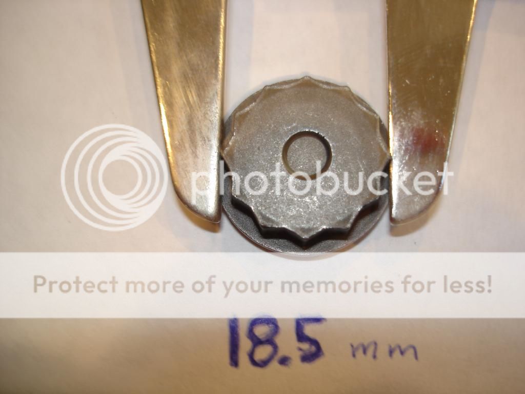

You want to grind the shoulder off so it is about 18.5mm-19mm overall width as shown. Taking this material off will allow you enough room to screw in your AR buffer tube:
