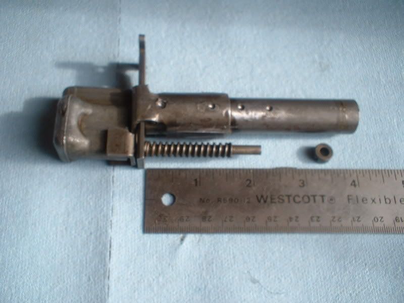

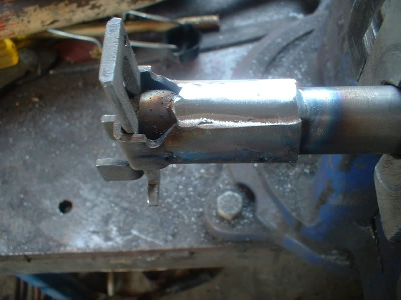

It took a while for the Ontario paperwork to go through, since the gun had to be transferred to the new owner first, then forwarded on to my dealer's. Once at my dealers, I went down to give it a good looking over to decide the course of action. After looking it over for almost an hour, I decided that by drilling out 8 spotwelds on the top, the barrel could be separated from the grips, which I assume would be the registered frame. A quick run out to the dealer's welder and a pin was installed through the barrel, since it could be interpreted as a prohibited device.

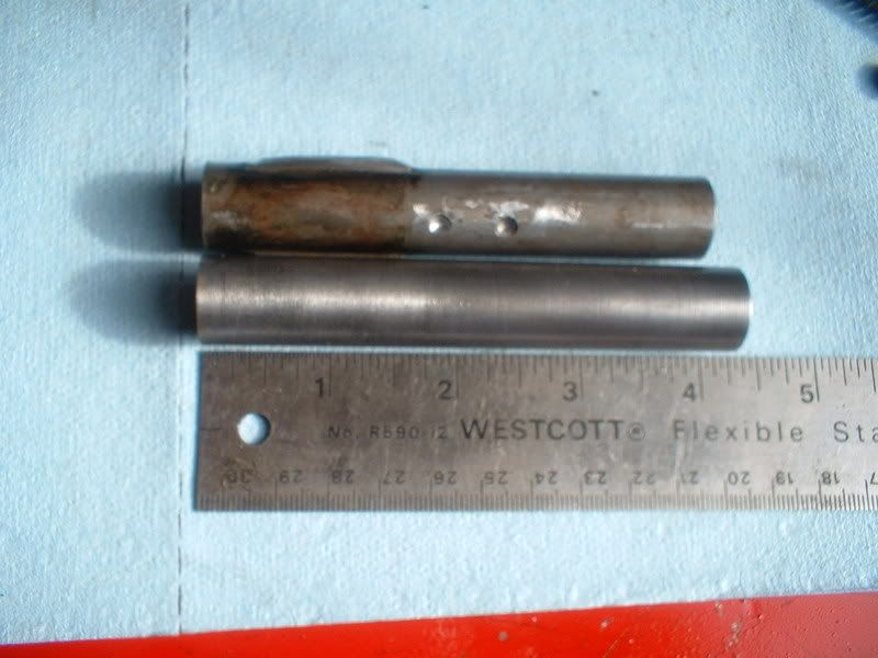

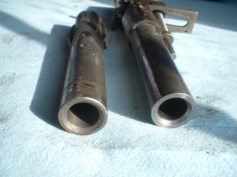

This was done at the dealer's, and I brought the upper home. A couple quick cuts to the barrel and it was seperated from the breech.

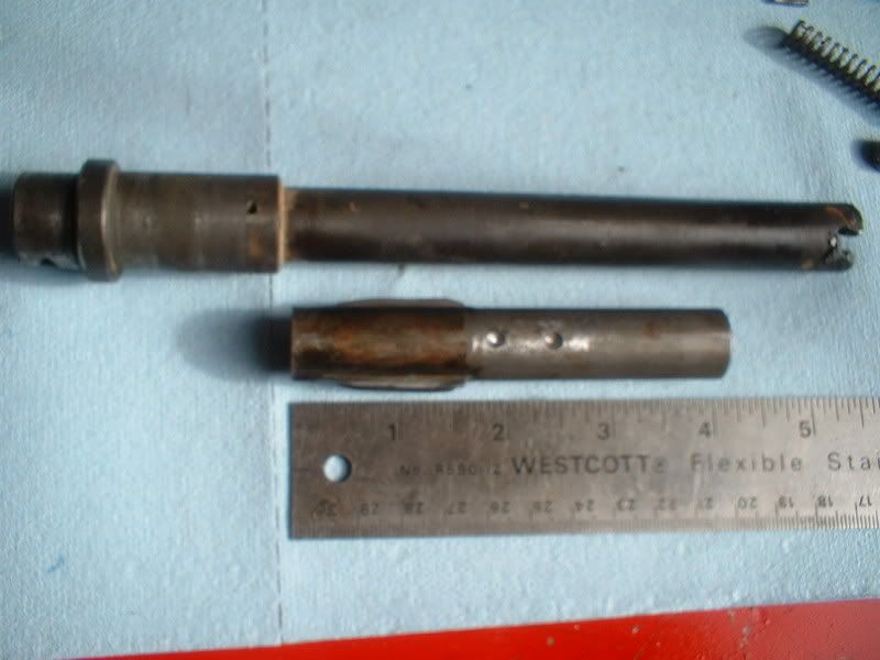

I looked over the project at home, and with some quick measurements decided that an old sten barrel could be used to make the new barrel. The outside diameter was almost right, and the steel would be a good enough quality for the project.

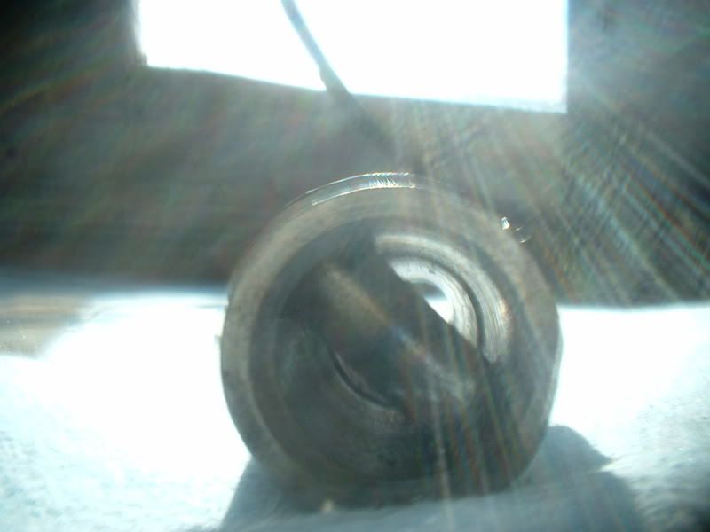

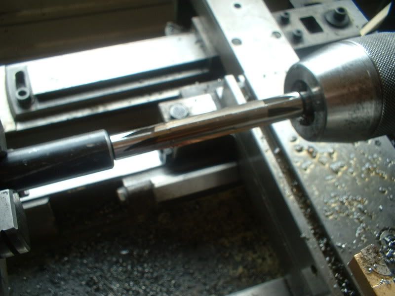

The 9mm barrel was drilled out to .451, which was the bore of the Liberator barrel. I was going to clean up the bore with a reamer, but quite frankly, it looked as good as the original, and lacked the pitting. I ordered in a chamber reamer from Brownell's and cut the chamber

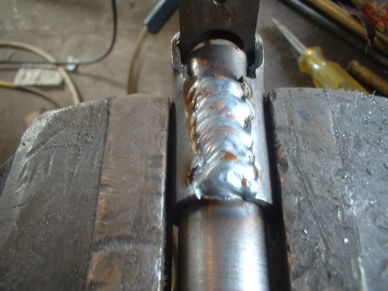

The next step was to weld the barrel back in to it's bracket.

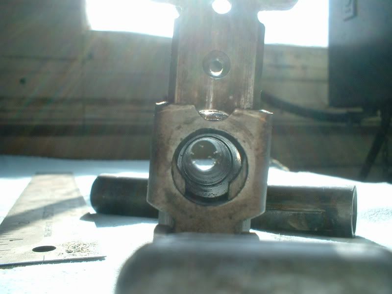

After welding in the barrel, slight deformation occurred in the chamber. A few turns with the reamer fixed that.
A quick run back to the dealers, and the use of his mig welder, had the barrel back onto the frame. This will just be temporary until I get a chance to get it properly spot welded.

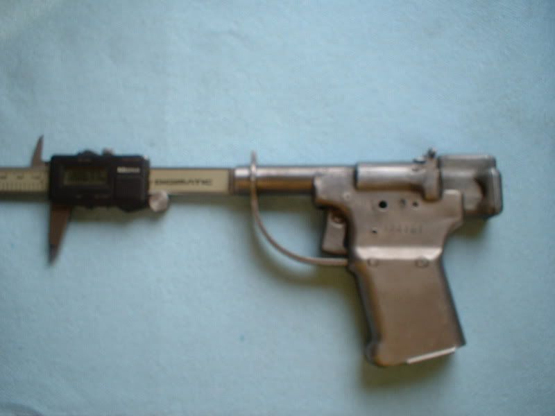

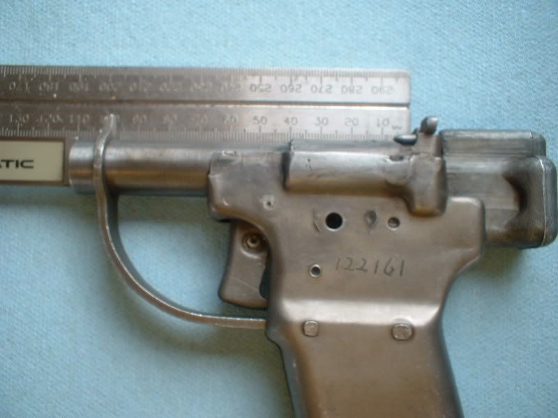

The barrel now is 106.75mm. The safety of Canadians is no longer in jeopardy.
The dealer sent in the new verification of the gun, and it has now been classed as restricted. The transfer to me was approved last week, and I'll head out this week to pick it up once I get a short term ATT.
