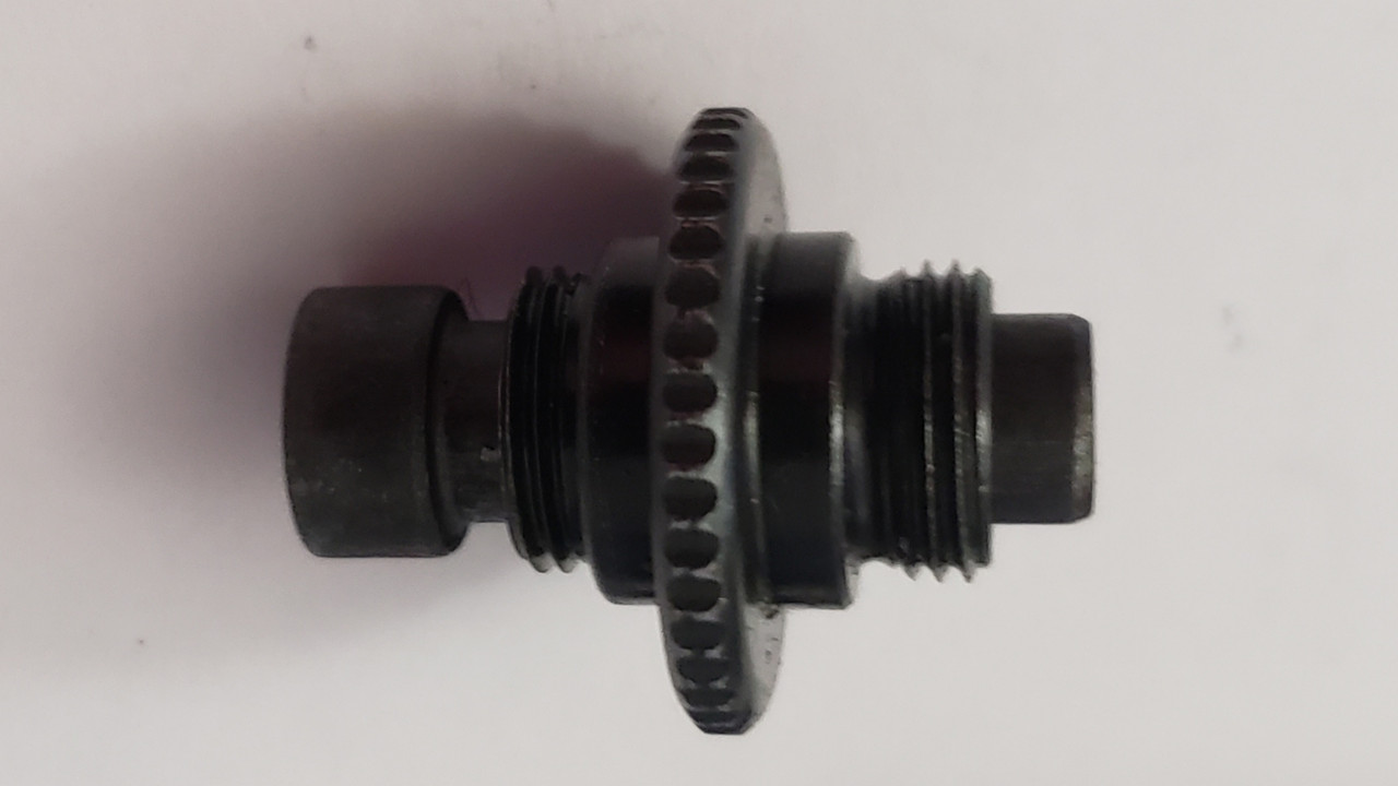

Here is a pic of the adjustment mechanism. The knurled piece is threaded and rides in 2 nuts held captive in the body. It acts as a stop for how high the pin can travel up in its stroke. You can see my shim on the top of the pin to the right in the pic.
As you can see in the next pic one side of the threaded adjuster has been machined shorter. I can install the whole assembly upside down with more threads to the bottom of the tool but that makes the primer ram even lower at the top of its stroke. FA machined the threads down to allow the pin to move up high enough in the stroke to hopefully get the primers fully seated. This put a bandaid on a design/manufacturing error as my priming tool actually comes out of the bottom nut at the top of the adjustment. The pin should be longer and the geometry is off for the tool to work properly in my opinion. They must have fixed it in newer runs and dumped these on Amazon.
