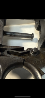

Hi, I'm trying to fix a french 1873 that has a broken trigger return spring, would you know where I can find one? Pic shows the broken trigger return spring, thanks.

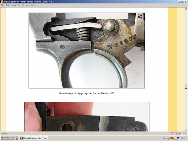

Maybe something like this would though:
Found here: ht tp://www.hlebooks.com/ebook/kn1873en.htm
That would likely perform the same function.
No doubt a coiled spring like the one from a clothespin could be made from spring wire.

The coil spring idea is good because i cant see how that could ever fail. be a good upgrade to keep original springs in original shape before they break.

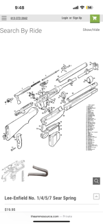

Lee enfield sear catch spring works perfect. Just cut slightly shorter and sand sides down so frame doesn't press on it
