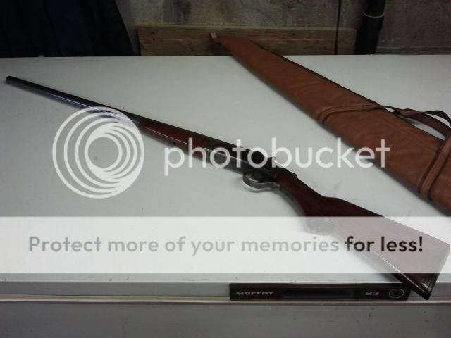

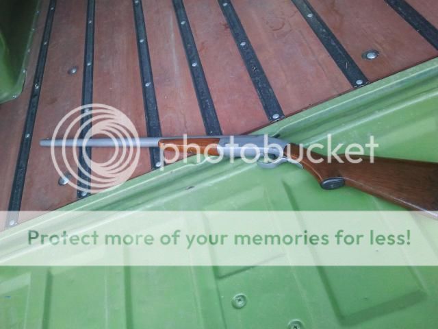

For a while I have wanted to take an old gun and make it nice again. I looked all around online and did a bunch of research trying to figure out how I wanted to do it. I wanted something unique. I started with an old Iver Johnson shotgun that I paid very little for. My plan centered around making a good truck/camp gun. Something that would hopefully survive the elements. I don't have the facilities to try my hand at Hot Blueing yet, so I started researching other options. Much to the disdain of my buddies, I considered Chrome (or similar) but I don't have anywhere local that does it and I wanted to see the whole process unfold. I looked into powder coating, but the local guy who does it "didn't feel comfortable working on guns". With the idea of shiny chrome still in my mind, I wondered about just sanding off what remained of the old finish and leaving it bare metal. I didn't think that would last long without rusting, so I had to come up with a solution. After some pondering, I settled on a clear coat for the metal. Using a friend's sandblasting set up, I blasted the whole shotgun, gave it a wipe down and applied Engine clear coat. I couldn't find anything online of people clear coating their guns, so I figured I'd attempt it on a $50 gun. Engine paint is designed to be high heat resistant (not a big deal in a single shot firearm) and resistant to gas and oil (which means it should stay intact through cleanings)
I must say I love the look of it, and if it continues to last, I think I might try it again. I was donated an old Cooey 84 that has definitely seen better days by a buddy who came by my place as I was applying the clear coat to the Iver Johnson. I might attempt more sanding and polishing on the Cooey prior to clear coat to see if I can make it shine.
The Original

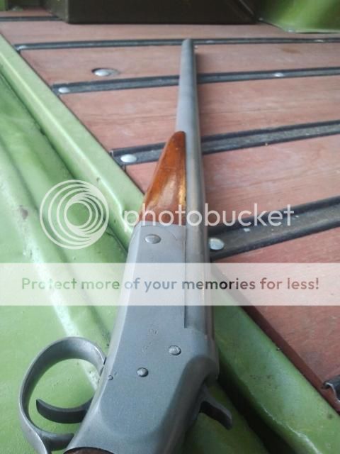

Close Up Of Receiver
Grit Blasted And Clearcoated
