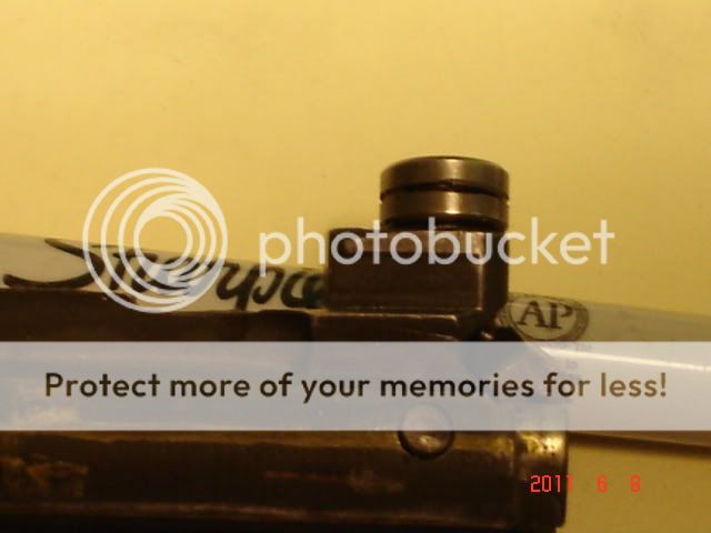

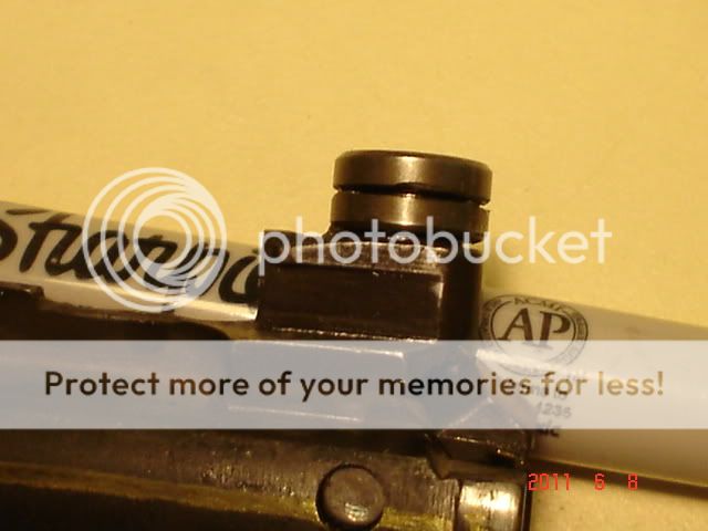

I decided today to inspect the new bolt after last night's firing of 50 rounds. (See previous posts).
The roller split longitudinally.

The roller failure was really bugging me so I examined the failure under a magnifying glass. I suspect a defect in the roller, as the failure occurred along the groove where the retaining ring holds the roller in place. Either the ring was oversized, the roller groove was cut too deep or the roller was too brittle and the forces exerted on the roller in the cycling action was too much for the metal to handle.

I looked at the failure and there are spots on the roller where the failure is angled outward. I believe that either the bearing surface was not even, had a burr or something or the retaining ring was oversized as compared to the track in the the roller.
The roller, prior to installation, did not bind and felt quite smooth when turning, mind you it was full of grease too.
When I remove the roller(s), I will be able to better inspect the bolt. But remembering my metalurgy class and the characteristics of certain failures, this one was either in the roller metal itself or something on the underside (such as the groove) to have such a uniform circumferential failure.
