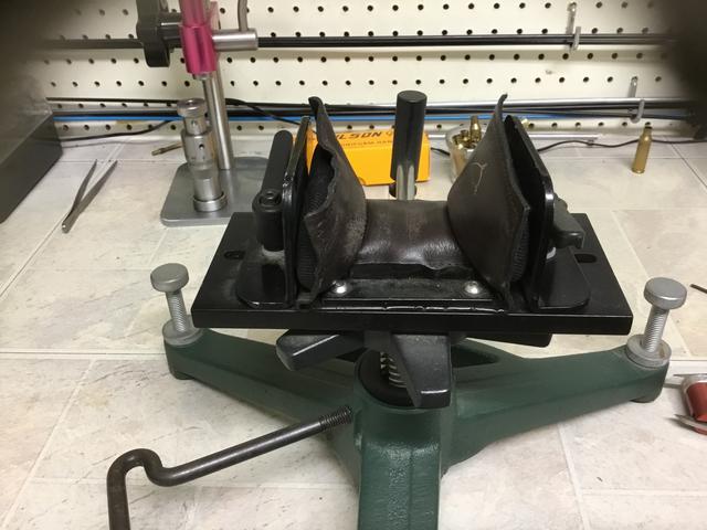

This is my main set up for the front rest. I purchased a Sinclair All Purpose saddle/bags and fit it on top of an the “Rock”. Threads were a bit different but it is doable. For the rear bag, I use an Edgewood gator filled with heavy sand. I recently purchased a mini gator but it collects dust (the bigger the better).
