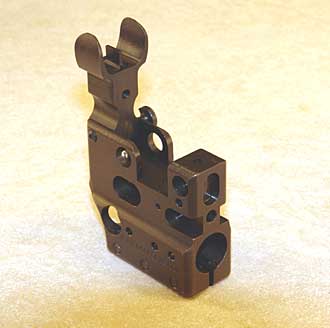

If you're going bolt-on (either a pic block or a flip-up block, sight built-in), I'd go with the pinch style. That's like the triple clamps that hold the forks on a motorcycle. They're the most secure type of non-pinned block.
Here's an option from GG&G, uses taper pins:
Here's the pinch-style:
And here, the less-desireable clamp-on style:
Finally, the least-desirable set-screw type:
I replaced my A2 sight tower with a YHM flip up sight/gas block.
'Took a whole ten minutes.

If you want to go the clamp style I like the PRI very much. Get it in 0.75" for standard barrels, stay away from the set screw versions.
Mounted on my gun:
IIRC The GGG with the pinned block needs to be done at GGG since barrels that have been pinned don't have them all in the same exact spot. (I checked on GGG website, needs to be sent for installation)
