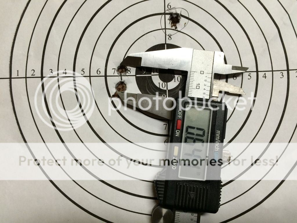

Hey guys, went to the range this afternoon to finish load development on my Carl gustafs 7mm. Was hoping to fire 20 of my hand loads and get this thing dialed in. Ended up going through all 60 rounds I had with me. I was only shooting three shot groups and the third shot was all over the place every time. Here are some pics:

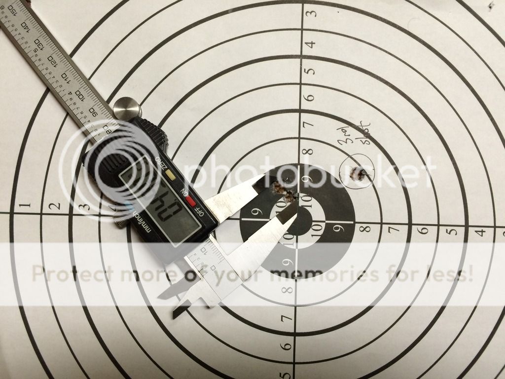

I was thinking it was me, but then thought the floated barrel might be touching as it warmed up. A guy at the range mentioned that the rifle might need a pressure point up front. (I floated this myself). So on my final group before I left I fired four rounds. The first two were close and the third was the same damned flier (shooter or rifle induced). I then fired a fourth shot and it ended up pretty much where the first two were.
Here's a pic:
Do you guys think it's me or the gun? I hope it's me because I don't know what to do with the rifle if it's the rifle. It's a 7mm rem mag. Maybe 60 rounds off the bench caused me to flinch? Open to any advice. I think the gun is capable of great accuracy and I want the only ####ty variable in the equation to be me.
