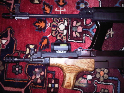

So.... it took me long enough but I finally got her out to the range. For those who didn't see my other pics, this is the set up I had.
I had to sight the Bushnell Trs-25 on the NEA rail so I started at 50 yards. I shot in three bunches on the targets below. I began aiming at the top left circle and was hitting directly below it. I then adjusted and POA and POI were the same. So, that means I was aiming and hitting the top left circle. Then, I just stood and did some free hand shots on the bottom right circle.

There were some downfalls to the day. The ak handguard I modded became extremely loose and I am sure it made the rifle less accurate. I made a thread about it and mentioned it had minimal play. That changed big time with shooting. The two pieces, bracket and hand guard were not attached in anyway. I am now thinking about how I can attach them together. I wonder what the strongest compound would be for beaver barf and wood. Epoxy or JB weld? Let me know if you guys have suggestions. Also, I did have a few failures to eject. I can't remember how many exactly.
The upside was really the NEA Rail and the Bushnell. The sight is excellent. I knew it was good before from stevo and other members reviews but I found out for myself today. I got excited and bought enough to furnish a few rifles.

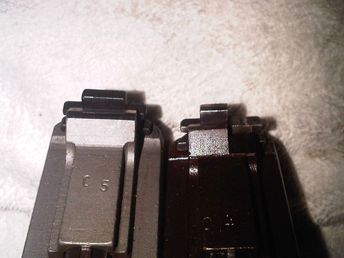

Also, when I was cleaning the rifle I realized the carriers and the hammers are different. The FSN carrier and hammer is cut to accommodate the bar on the inside right of the receiver that make it semi. What this means is that you can use the FSN carrier and hammer in a cz but not vice versa. You would have to mod your cz bolt and hammer to use in an FSN rifle. This is for those that might want to get an aftermarket carrier. Check it out.
Lastly, I epoxied the ak handguard to my beaver barf bracket and it is solid as a rock in terms of attachment. It was so tight it wouldn't even fit back on. I had to shoot it without the pin in the handguard for about 75 rounds until everything loosened up and it would fit again. I forgot the pin and bracket at home so I was stuck holding it in place and shooting. Kind of put a damper on the shooting. I got home and put the bracket in and the pin so now I hope I am done with trial and error. It is a really comfortable grip. I hope it functions like it should.
thats incorrect.
those cuts are also in the CZH2003 (VZ58 S&L) . the carriers and strikers are still interchangeable , the cuts prevent the use of the full auto sear .

thats incorrect.

Sorry Curton, you are incorrect...I can't get a "regular" bolt carrier or striker to work in my rifle.
The bolt carrier in my CZH 2003 is cut exactly like the OP's and there is a "bar" in the receiver. I recently bought a VZ Lightening bolt off the EE...
Guess what? It didn't fit my CZH 2003 due to the carrier and striker cut not being there.:mad:
So out came the calipers, a hack saw with a fresh blade, and my trusty vice. :eek:
It fits now.:D
i shouldnt have said the CZH cos i dont have one but .....
sorry clob, i just swapped the carriers, bolts & strikers from my 2 CZ to my 3 FSN and they all worked fine . the CZ non cut carriers cleared the bar on the right of receivers .
Weird. There must be something a little different with the CZH rifles. Thanks for testing it and the info.
