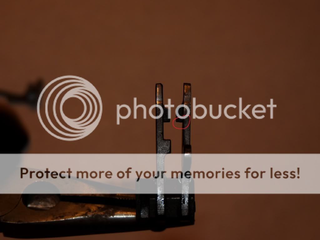

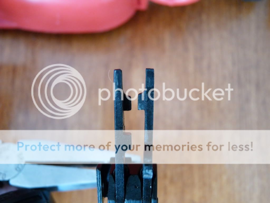

Problem: The sear was slipping off of the trigger arm causing the trigger to stick
Solution: filed this tab 90 degrees to the arm so the sear would sit flush on the tab.
I will post pictures of what the trigger arm looks like after the filing later tonight when i get my camera back.
Now i only shot 10 rounds so far and everything worked and no sticky trigger but i was only able to fire 1 round before. With the bolt out i was only able to squeeze the around 10 times before the sear slipped off the trigger arm. Now i can squeeze the trigger till my finger gets tired and the sear doesnt slide off the trigger arm.

AFTER:
Let me know if you guys want a better explanation or pictures.
