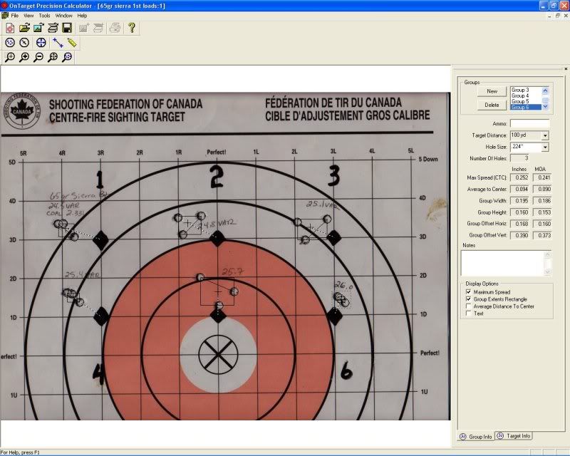

I recently did a small 3 shot test on some 65gr bullets out of my 12 twist .223. As you can see, I went up at .3gr increments and there are some definate differences in accuracy. I was meticulous about shooting the rounds in a sequence like 123cool the barrel 456 cool the barrel then start 234cool 561 cool etc.. Unfortuntely there was a quartering rear crosswind that day but again, I was more interested in seeing if I could make these bullets fly. Not sure if that is the reson I have an angled stringing to my groups or not but there is definately a top left to down right pattern to the groups. The scatter group stands out like a sore thumb though!
In this case, I was more interested in knowing that I could stabilize 65gr bullets but the results defintely have given me some data to build on.
I use a Lee Collet die.
The gun is a used 1989 factory barrel and trigger REM700 BDL with a custom boyds/bedded stock. Hoping to work this 65 gr load into a .3 or less MOA load.
