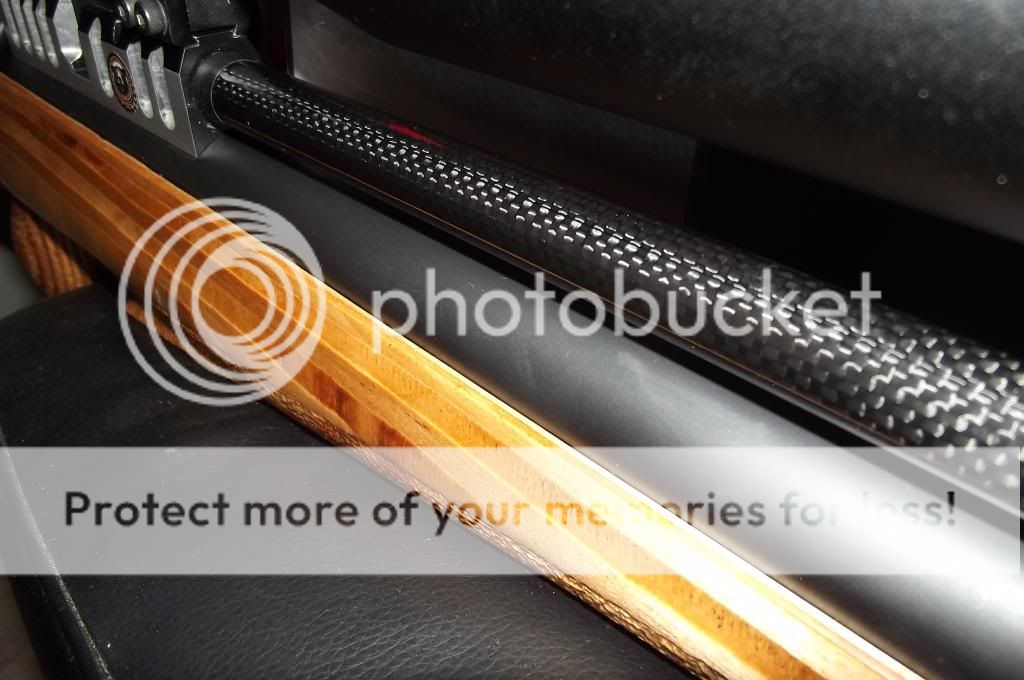

For a reason or another, I expected the laminated to look like this?

Whoops, definitely meant synthetic stock! The laminate hasn't even made its way into Canada yet. A bit of a bummer on the leak, but it didn't take long to fix. It does indeed seem common with FX rifles, but from what I've seen it's just an o-ring replacement and they're good to go. That was the case with mine... The regulator has 2 o-rings sealing it to the air tube, and one was perhaps damaged when it was installed. I have no concerns moving forward, despite the general unrest caused by what seems to be non-owners of FX rifles. I'm happy to support a company that is continually pushing the boundaries, while also managing to bag so many top places at competitions.
They said they were meant to have a shroud, but the delivery would have been delayed significantly, as they have had trouble keeping up on making the shrouds. After some measurements that Gerard and I took, we found that the shroud would have been barely larger than the OD of my barrel. Either the shroud has very low air volume, or the standard barrel was thinner.
