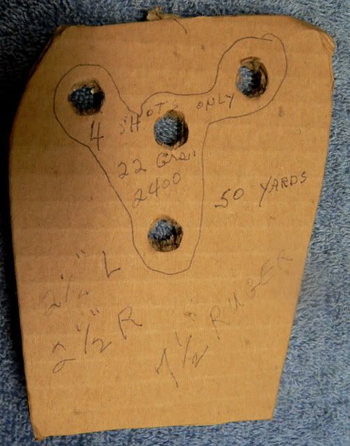

I might add, however, that I have shot a few thousand flat base (without gas check) cast bullets in 44 magnum revolvers, and for the most part, leading was not too bad. I still have to prove whether gas check, or flat base, is most accurate in the Marlin, as I have both bullet designs.
Here is a picture of a piece of cardboard target I cut out and saved, from beneath my aiming mark. The story is told by the pencil notations on it, made at the time of shooting, except to say that it was a flat base bullet.
Also, I was resting the gun over a sand bag, sighting it in.
