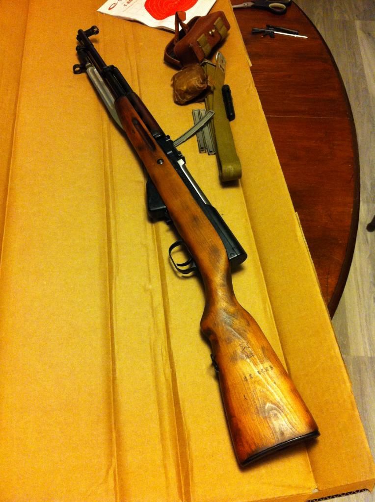

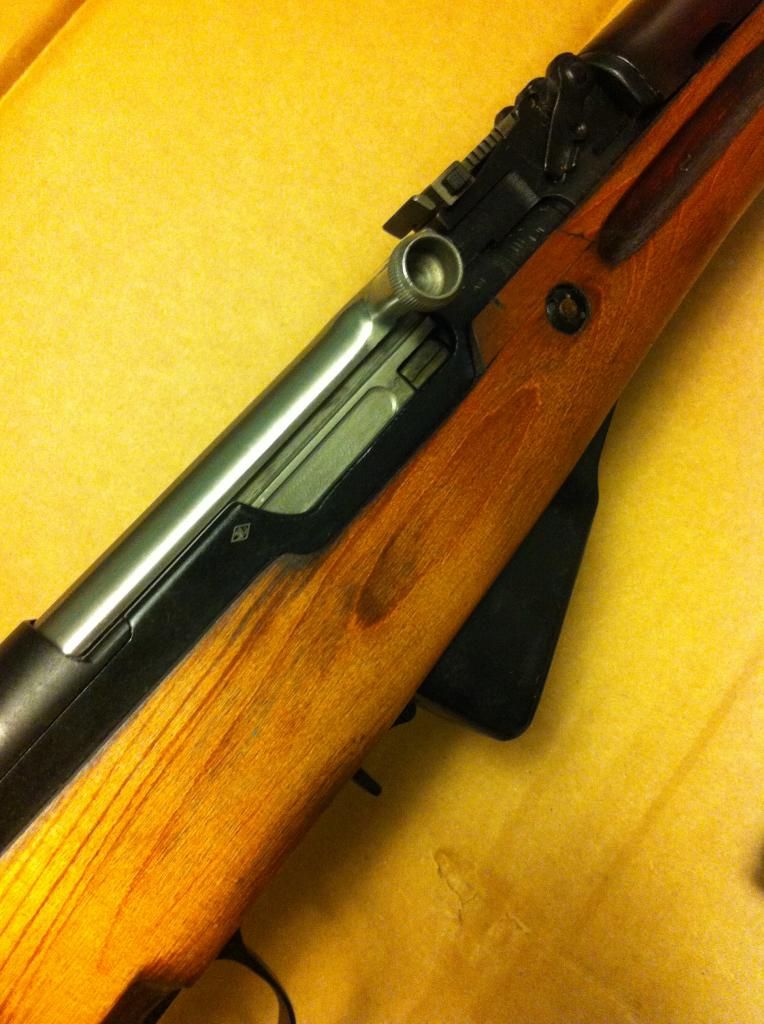

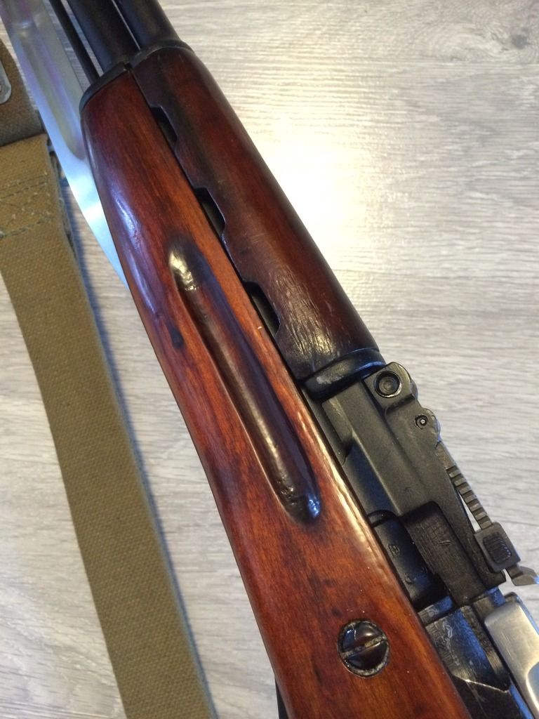

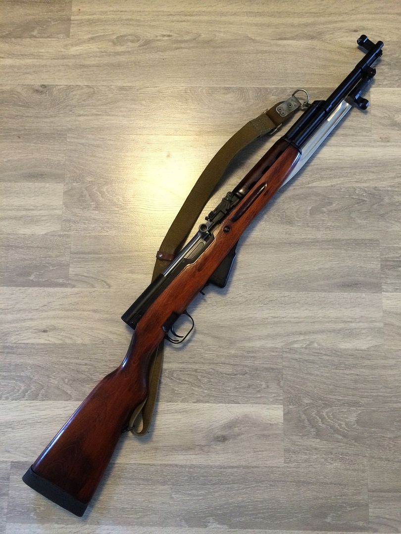

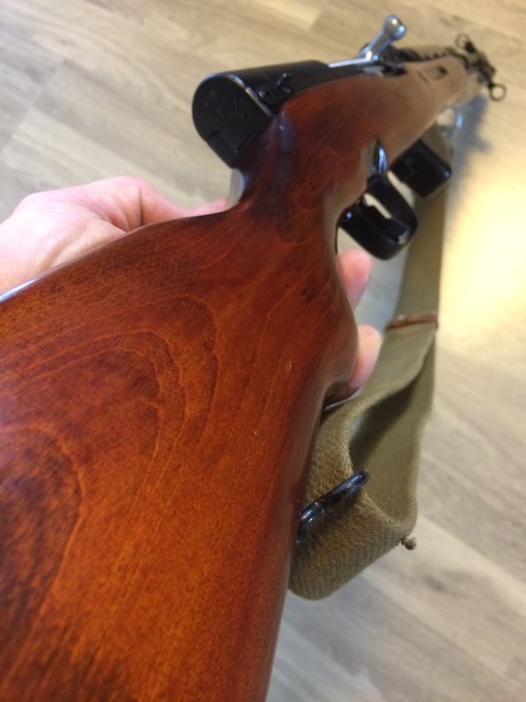

Here's a couple before and after pics of my 51 Tula I refinished a couple weeks ago, it was part of Canam's sks and a crate of norc non corrosive last year.
Typical molot import, parkerized black with heavily sanded stock. Upper handguard was unsanded. I gave it 3-4 new coats of Amber shellac and buffed it with 000 steel wool to take down the shine. It's not as dark as the handguard but I'm happy with it, it's a shooter and not a safe queen so I figured it was about time to make it a bit easier on the eyes.
Have an svt40 with flaking shellac to do next, just have to figure out what to tint shellac with to match the dark red tone of it.
Before
And after

What kind of recoil pad and where did you find it?
Do it, due to mine being sanded smooth already it was easy. Schlac dries quick fast so I did four coats with 30-60 min between coats and then it hung for a week to fully dry and harden before I steel wooled it, all I did was wipe it down good with a wax and grease remover before the first coat.
The butt pad is from CGN member mobular, they're chicom sks butt pads. I grabbed some to extend the lop by an inch one this rifle and my other laminate, they're great and he sells them for around $12-15 with longer screws inc. I highly recommend them if you find the sks stock too short, I don't find the recoil much with or without it so can't comment on that lol.

@EL34/6L6 it was sanded too heavily to leave as it was, if it hadn't been sanded and had just showed its age I could see leaving it as is. I can always scuff the shine down more. It's more semi-gloss at the moment, although pure gloss looked pretty nice. It'll get scuffed up after I shoot it a few times lol.
