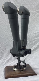

Recent purchase …. A desk ornament. An SF14 that has sat on its direction dial!

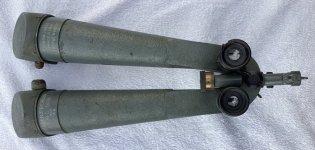

Some more images. Still trying to understand the lettering. SF14H or SF14G etc.
