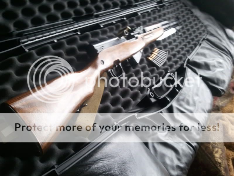

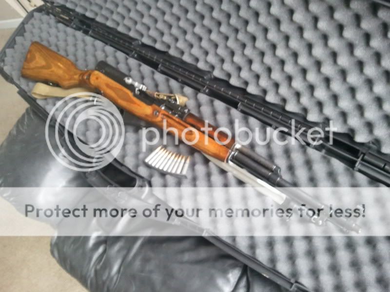

Got a new (my first) Russian SKS:
So - on taking this thing apart and doing the big degrease... I had a buddy nearby with his own SKS doing a step by step. I've been made aware that the firing pin should shuffle back and forth by it's own weight - mine does not. Too much gunk in there.
I've tried to knock the pin holding it all together out of it's place but it will NOT budge - is there a trick to it?
