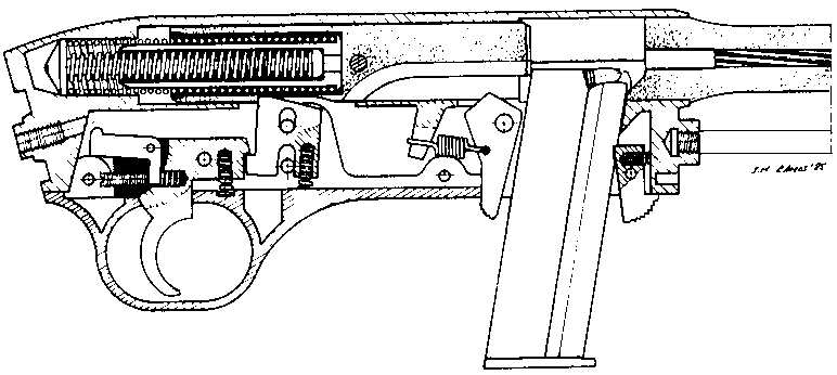

I have owned these and found accuracy to be excellent when held security in shooting bags on a bench. Obviously it takes extra care to shoot this type of action well while standing. I did a chronograph test with various 22lr ammunitions in the Gevarm and other brands and types of 22lr actions. The double firing pin strike of the Gevarm always gave a more consistent velocity than any other action . It has lead me to think that at some point I would like to duplicate this double strike firing pin on a bolt action 22lr. I believe it would be a sicnificant advantage in a target 22lr bolt action.

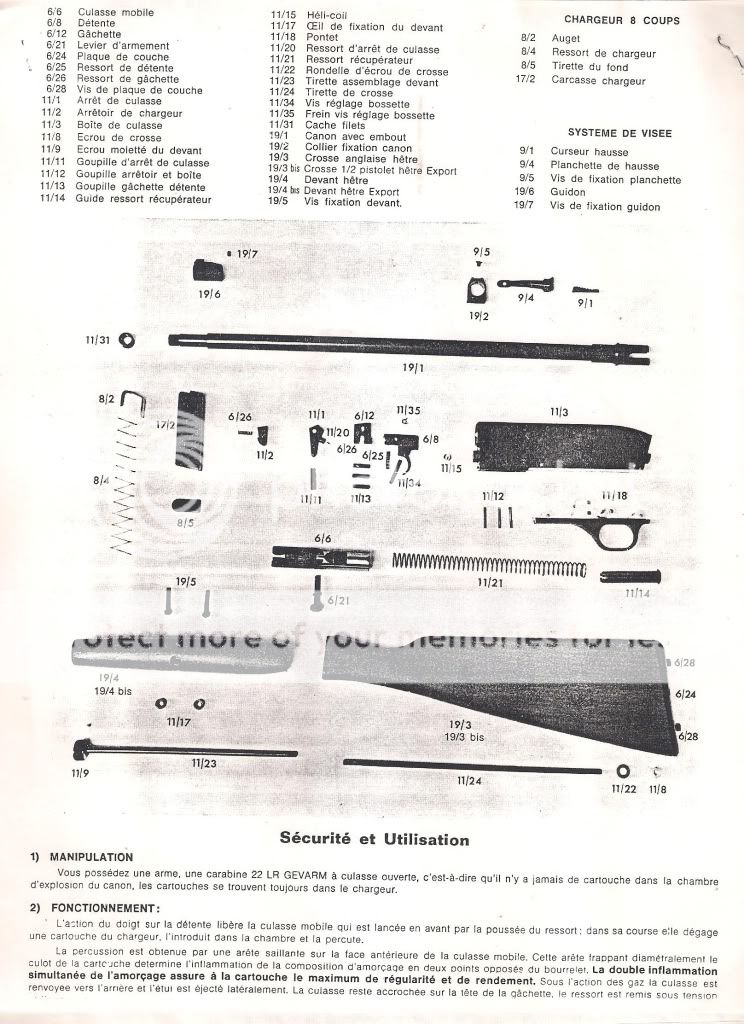

View attachment 101989View attachment 101990
Hey Tom if you look at that parts diagram you posted you will see an adjustment screw behind the trigger, it adjusts the second stage of the trigger pull. Glass bedding the barrel and the rear of the fore stock where it contacts the receiver greatly improved the accuracy but it would not stay sighted in with a scope mounted on the reciever so I mounted a pistol scope on the barrel. Now it stays sighted in.
