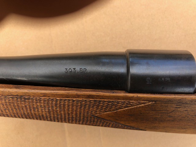

GEW 98 Mauser chambered for 303 British.

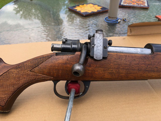

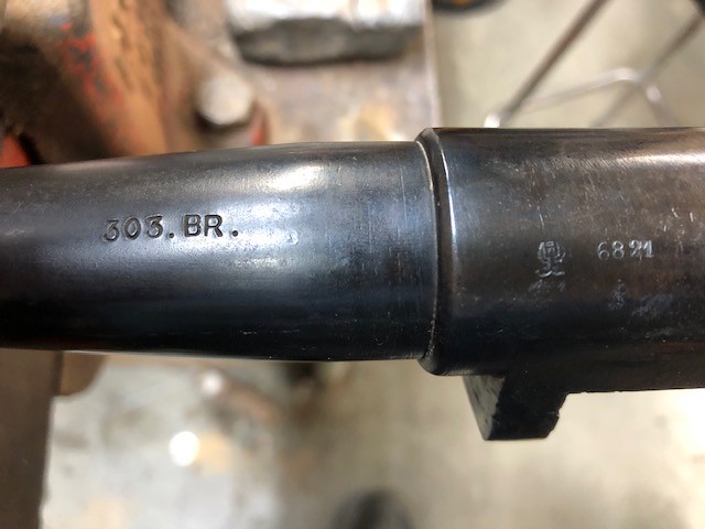

I came across this old GEW 98 that surprised me with the chamber area stamped 303 British.

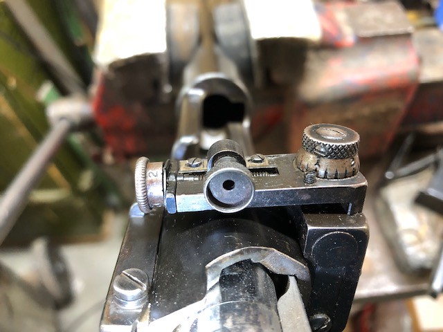

From the stock design and the very early style #48 Lyman rear sight, I'm thinking mid 1930s.
It's obviously a custom job, likely by one of the European cottage builders but there are only early type acceptance marks on the receiver, which is all matching. May even have been done in Canada as the European cottage builders would have had to get it certified to sell.
There's nothing special about this rifle other than the chambering and the alterations to the bolt face, extractor and cartridge guide rails of the receiver.
At first appearances it looked to be just another GEW 98 that had been sporterized but very well by someone that definitely knew what they were doing.
This rifle was put together before scopes were almost deemed to be mandatory and isn't drilled or tapped for the mount screws, but the receiver has been milled to remove all martial markings or country of origin, other than the serial number and acceptance stamp/model stamp.
The trigger was done by an expert and breaks crisply and repeatably under three pounds.
The major groove diameter measures at .315in and the minor diameter measures at .307 so it should be a good shooter.
The chamber is right on minimum spec dimensions and I had to root through my die sets to find one that would set back the shoulder and reduce the diameter above the rim to minimum factory specs to get the resized cases to chamber properly, without having to apply force to the bolt. Factory rounds chamber well but a few of the PPU rims with thicker rims were a bit snug, not enough to cause any issues.
The bore is excellent. Looking forward to play with this old hunter and maybe, if it wants to shoot the .312 bullets I have on hand well, get drilled and tapped for a scope for my old eyes.

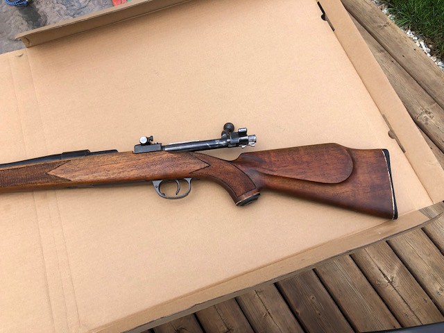

I've go the rifle apart right now and found that the stock maker, who was meticulous with the inletting was "to meticulous''
The stock has split under the receiver and was never bedded or had pillars added, not even a recoil bar behind the receiver lug. Thankfully it had been stored in such a manner it didn't get rusty, but the stock has checks all through it. Not really a great piece of Walnut that likely wasn't fully cured when it was shaped and inletted.
The stock, sadly isn't salvageable IMHO, so I'm going to look around for something appropriate or modify something I have on hand to ''look and feel right"
First I'm going to clean everything up and mount it in another stock I have on hand that's much more modern but sound. It will need to be modified for the rear receiver sight to clear the stock, just in front of the bolt recess. Ugh a weak spot.

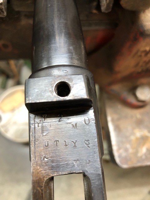

For those that wanted pics.
It's pretty obvious that the recoil shoulder was built up with weld then drilled and tapped OFF CENTER.
This rifle was put together by someone with reasonable skills. The off center retaining screw hole is about the only poorly done job on it. Even the King Screw was hand made and it's threaded on a lathe for 1/4NF.
The stock was one I had in the bin and from the design of the original, it's about 10-15 years newer.
Now to see how well it shoots. If it proves to shoot well, then it will get a new set of holes drilled and tapped in the receiver for scope bases and it may even get an after market adjustable trigger.
The mag holds three rounds and feeds flawlessly.

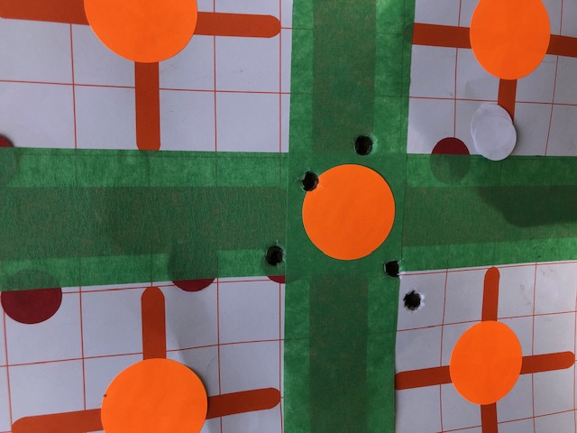

Took the rifle out today and put twenty rounds through it, ten at fifty yards and ten at one hundred yards.
The first fife shot group was very promicing, around 3/4in at 50 yds
The next group of five showed me there's a bedding issue. The vertical dispersion is around a half inch but the horizontal opened up to two inches.
The next five shot group at 100yds the vertical dispersion is about an inch and the horizontal dispersion spread out to six inches.
The last five shot group was identical
The load I'm using would be considered to hot for No1 or No4 rifles.
It's fine for my GEW98 or an Enfield, but don't attempt to use it in other types of firearms chambered for the 303 British.
It's 48.0 grains of IMR4320, over CCI 200LR primers, under Speer 180 grain flat base, round nose bullets
YES, it's an OVER MAX LOAD and I don't suggest anyone else should use it unless they have a rifle that is built on an action strong enough for it.
My mangetospeed tells me the velocities are just over 2740fps over a ten shot average and there are no signs of pressure or case stretching

The original recoil lug has been built up with weld to be at least twice as deep as it was originally. I don't know by whom.
My guess is there is a broken off King Screw bolt in the original hole or it was stripped out. The new King Screw is lathe made and threaded 1/4NF. as is the hole on the bottom of the recoul lug.
