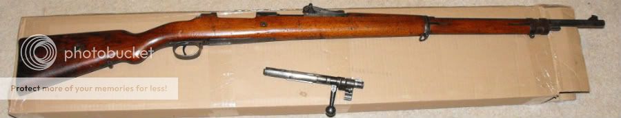

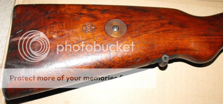

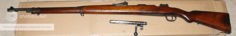

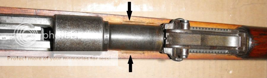

I just picked up a Gew 98 made by Spandau in 1905 and being a Lee Enfield guy I am trying to learn more about these Mausers. It came without a cleaning rod or top wood so I placed a back-up k98 one on it. My main concern with it is the stock although a early stock it looks like it would have been on a rifle with different top wood and sight (see picture). It also had a with a six pointed star and a B in it. Can any of you Gew98 experts tell me more?
Thanks
Your stock has been to Brazil; that 6-pointed star indicates Brazil police/defense district B.
Likely the stock would have come from a Brazilian Model of 1909 rifle which was simply a commercially-made Gew 98 in 7x57: very close indeed to the German rifle and all mechanical parts interchanging despite the different rear sight. Your rifle has the correct "Lange" sight for that period.
One thing about a 1905 rifle is that you have no worries regarding a tight bore: the changeover in the ammo took place in 1904 and everything made after that date can handle the JS loading: 154-grain pointed flatbase bullet at 2880 ft/sec, which is hotter than a .30-06.

Brazilian M1908 stock on a German Gewehr 1898 rifle, that is why the handguard inletting is wrong.
Well it looks like I will have to find a WWI or earlier stock the one without the finger groove, please let me know where I can find the part needed to bring it back to its full glory. To give a little more on the rifle all the numbers on the body match but it has a unnumbered bolt, it was also counter bored sometime in its service life. I have been looking for a WW1 German used rifle and I think this fits the bill.
