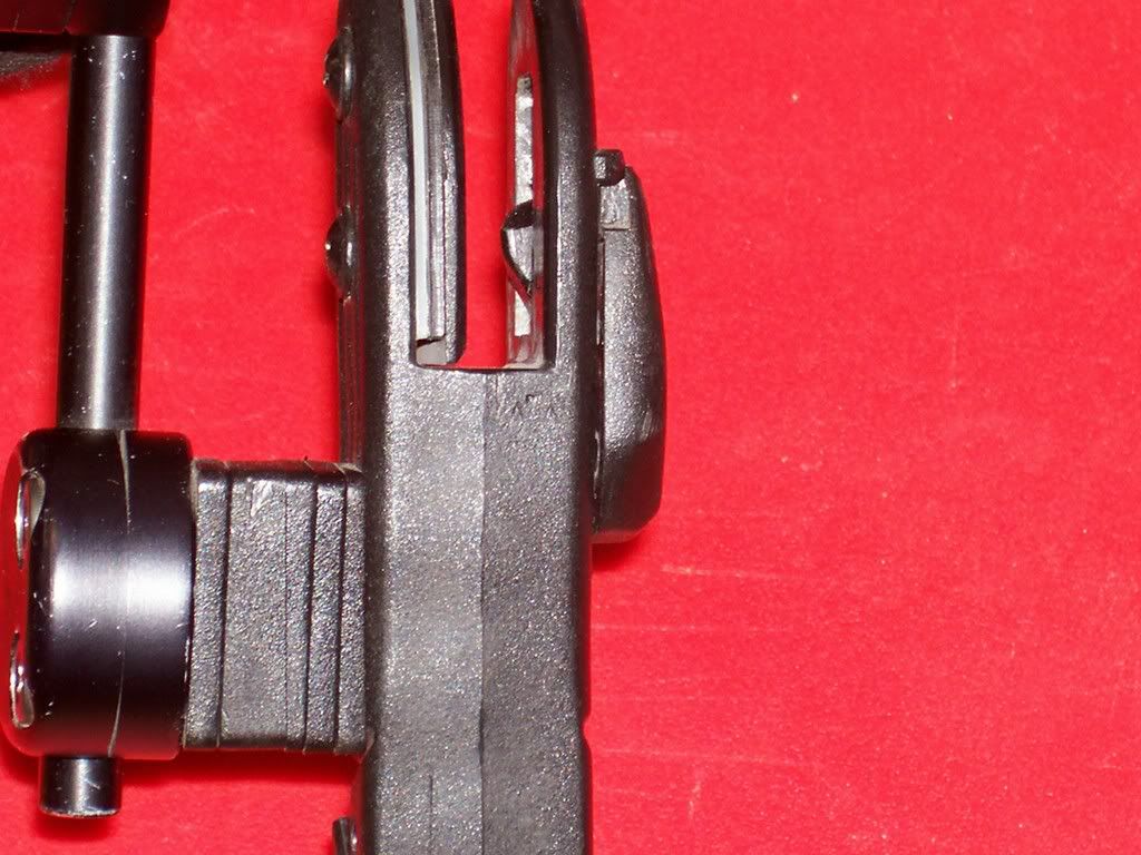

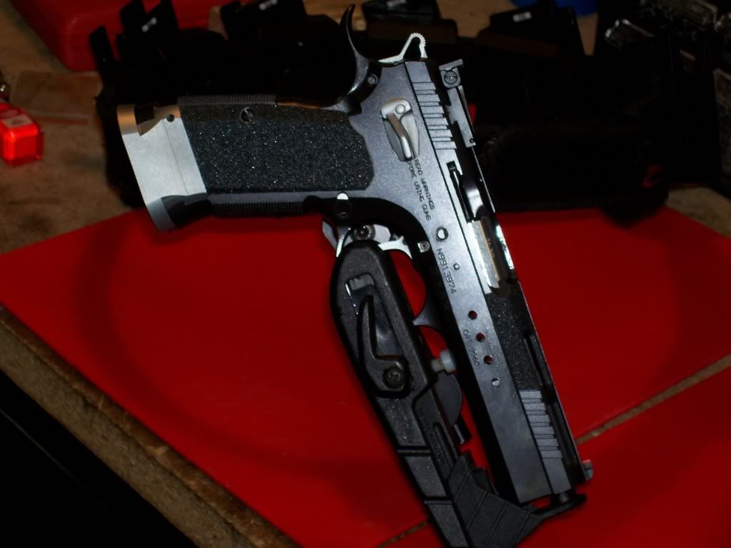

CR-Speed and square Tanfoglio trigger guards don't play well together. The holster can be rigged to hold the gun securely, but it requires some pretty extensive modification. See modification here:

I am not aware of a specific CR-Speed holster made for them but that doesn't mean there isn't one. In any case, for a production rig I would stick with the BT. That way you can use it in the U.S. for Production Division whereas, the various flavors of bikini holsters are not approved.
I even had Sean at Freedom set one up for me ... still didn't feel right .. snatchy on the draw, wobbly sitting in it ... either that or so freakin tight that it pulled my belt up as I was drawing ... not good ... I know one guy who had his Tanfo fall out of the CR Speed as he was moving ... DQ ...
