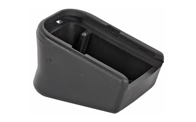

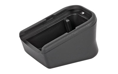

Glock OEM MAG EXTENSION 9/40/357 4.99USD each In Canada

Please click picture for link to site

In the description is says you need a magazine insert, which is sold separately. Can you use the current one in the mag or is it a different part? And if it’s a different part, do you have them?
You can use the current insert, they are all the same.

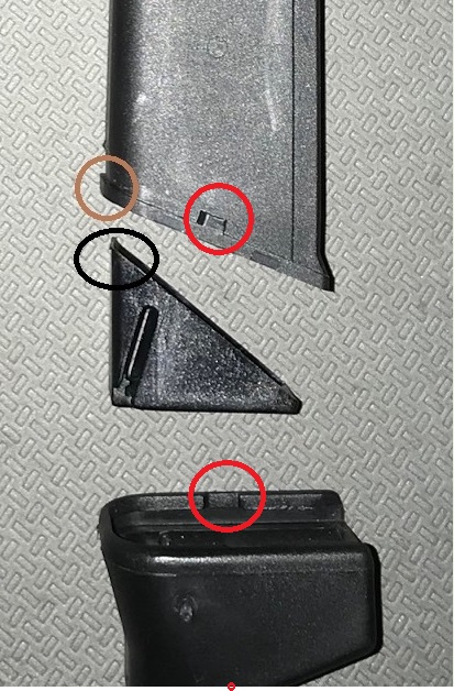

This is not a confrontational reply but to further clarify, the areas circled in red is what stops the base plate from coming off.
The channel on the base plate that mates to the base of the magazine further enhances it rigidity. It truly is one of the best designed magazines out there.
The mag insert is there to coddle the spring and allow you to compress the spring to make it easier to get the base plate off, nothing more.
You can drop it all you want, sh!t you can throw it and will not come apart.

The area circled in red assist to hold the base plate on, but is defeated by force every time you assemble or dis-assemble the mag. Meaning you push the base plate passed the ridge. The properly installed insert on the other hand MUST be moved out of the way or the mag is not coming apart.
So to review, with the properly installed insert, you move it out of the way and force the base plate over the red circles area.
Or without the insert, you simply force the base plate over the red circled area.

Again as noted in my previous reply, this is not about what I want, or what will happen, I am speaking of actual experience of what has happened.
