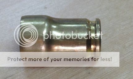

Conversion kit? If you have a Glock 22, you don't have to do anything... Just load up some 9mm and let 'er fly...
At least that's what the guy in the lane beside me tried a few weeks ago.
Here's a photo of a piece of brass I scooped...
