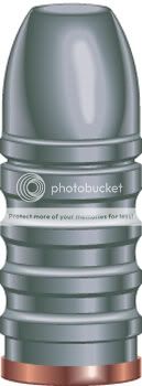

I have a Win 94BB in 375 Win and it is a great cast shooter, I cast my own RCBS 250 gr gas check bullets.
