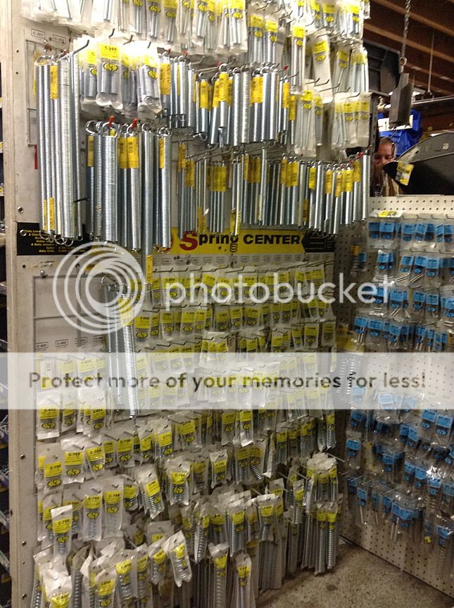

You didn't mention your location. For folks near Vancouver who may go Bellingham from time to time, Hardware Sales in Bellingham has a pretty darned good selection of springs at the back of their Fasteners aisle.
Actually, they are far and away the best hardware store I've ever been in, bar none. Basically an industrial supplier that caters to the public. Not open Sundays.
You can check them out here.
