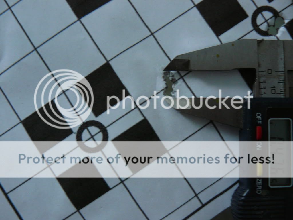

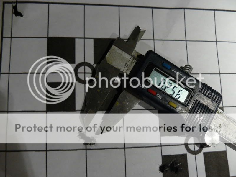

I bumped my usual warm weather load of 24.5gr Varget up .1 and .2 gr and also tried a few different OAL. I think I found a winner with COAL of 2.410, 24.7 gr Varget lit with a BR-4 primer pushing 80gr Amax at 2860fps -2 degC. The results were similar to 24.5 gr in 20-30 deg weather (five shots into .330). Rifle is a Tikka Varmint .223rem 1:8 twist with a Vortex Crossfire 6-24X50MD. Shot this 5 rd group at 100yd today.:D
5 shots? But why are you measuring just 3 holes... the 2 other ones are at the lower right of the pictures!
The caliper appears to be centered on one hole,but it looks like it needs to be opened a bit to be centered on the other as well.;)
Nice shooting, but the picture really doesn't look like a five shot .256" group.It may very well be a five shot .256" group,but the picture just doesn't look like it.
I agree the picture is deceiving. The shadow and the grid lines on the target cause something of an illusion. I remeasured today in better light, OD to OD subtract .224 from .476 = .252.;) Not my best group with this rifle, but so far the best with the 80gr Amax. I have one of those pistol grip infrared thermometers and I'm trying to establish some proven data on powder charge vs ambient temp vs chamber temp.
