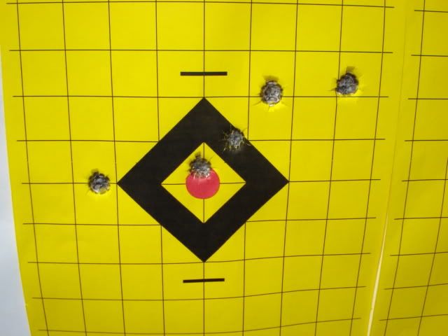

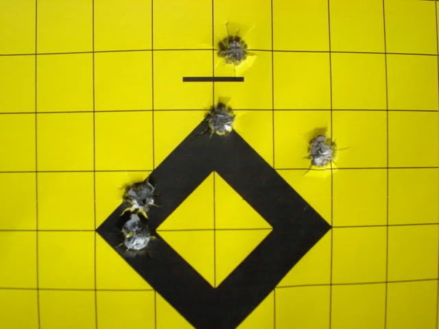

Ball load
Amax load
750 solids
if their was three shots together at 2 hundred it would look a bit better. I dont know alot about fifitys but your other groups looked pretty bad.. Is it that hard to get those guns to shoot, i only own guns up to a 300win mag.

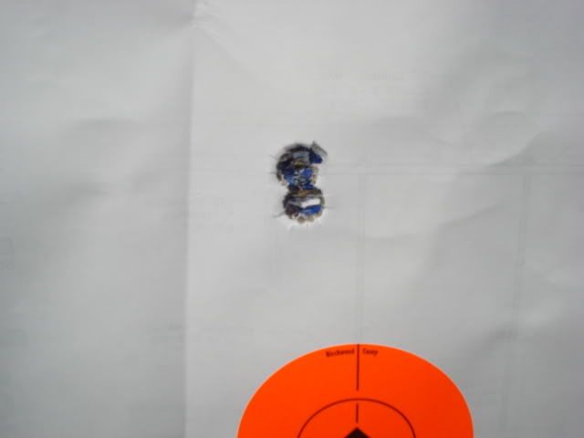

I'm gonna post a pic below here, this was from a load that took about 6 weeks of experimenting to get. 205 gr. of H 5010 with a 647 gr. Ball , pulled bullet. There's a flyer that's my fault, I flinched just before breaking the trigger when a black powder gun beside me went off with no warning.
