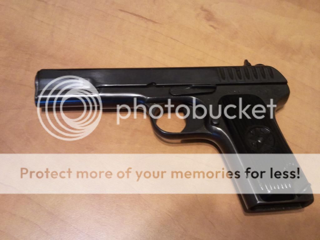

Got my new TT-33, Very happy with service.
Let me start off by saying im super happy with my dealings with Marstar. They waited a VERY long time for the RCMP to finally get there ass in gear and put my Rpal through and never complained. Once my Rpal was through it was literally days before the gun was at my door packaged in a nice hard case.

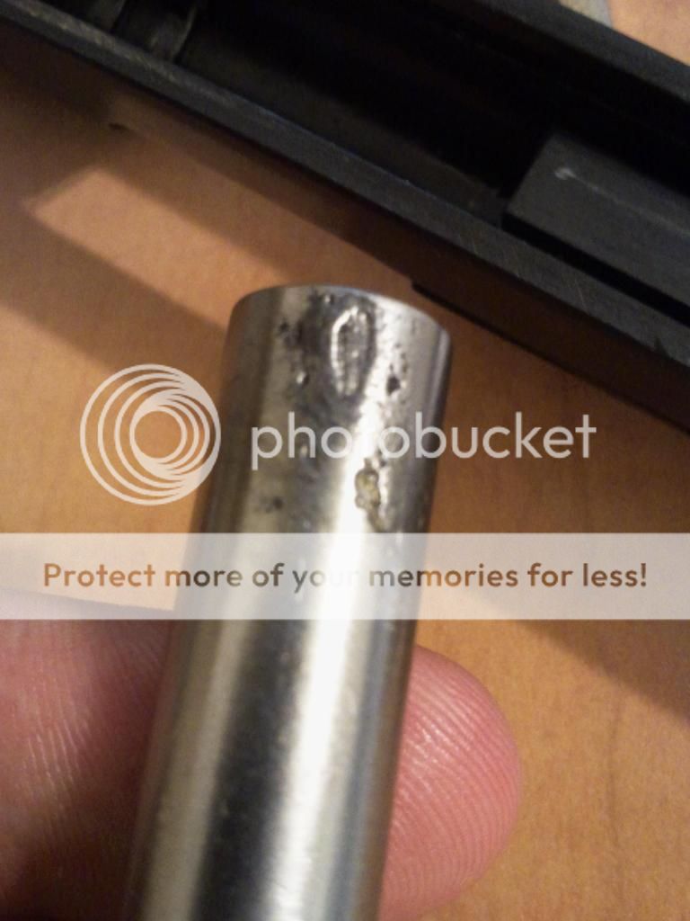

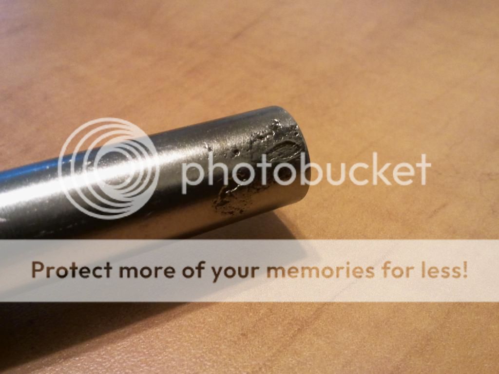

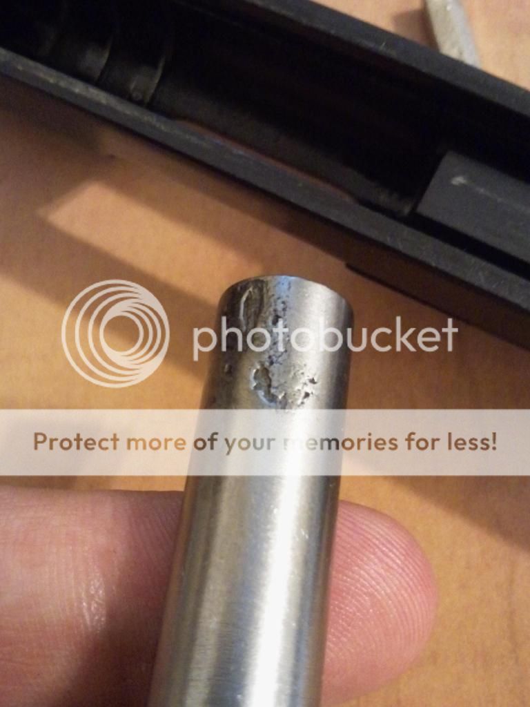

The gun is very nice externally, no noticeable bluing wear, its a 1939 which i think is cool, overall its in VG condition. Except, there is a large... something on the end of the barrel, it almost looks like a casting defect or possible super bad rust that was buffed out I do not know. I want to make it clear im not making a ##### thread here im just concerned about whether the barrel is OK as it is probably close to .015-.02" deep at its deepest, please see the pictures and judge. If this is something that you sometimes encounter with these surplus guns just go ahead and ignore me and delete the thread but i want to be sure nothing crazy is going to happen the first time I pull the trigger.
Now the pics, Let me know what you think.

My TT-33 has some slight pitting on the barrel, I accept it as remnants of rust on a war era gun. Not as deep as that but closer to the chamber and I feel safe shooting it.

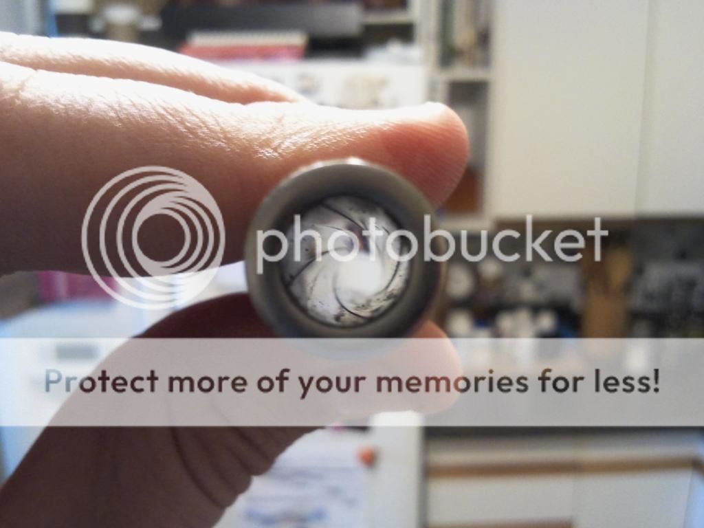

But each gun is different... the picture of the inside of the barrel is unclear and if there is internal pitting that lines up with the external pitting then there is a chance that the barrel rusted through and could fail in an unexpected way.
Either way, if Marstar is willing to exchange you might as well take it. Matching numbers are nice but a safe shootable gun is even nicer.
I think if you just sent back the barrel, Marstar might send you a new one back. Marstar has a reputation of being really good about things like that.
I would keep that barrel. It's not unsafe, and is the remains of rust that was removed at refurb in Russian. The bore looks great, better than most. I'd keep it.
I have decided to keep it, I don't think its worth separating the original barrel from the gun if its only cosmetic. I will email john just to confirm he believes its safe to use as is but I was never worried about it as a cosmetic flaw just wondering if it was going to be a structural flaw in the barrel.
