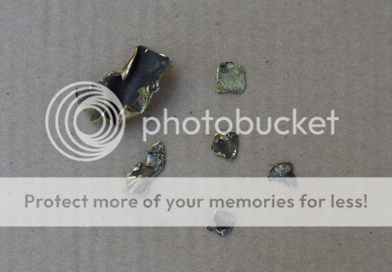

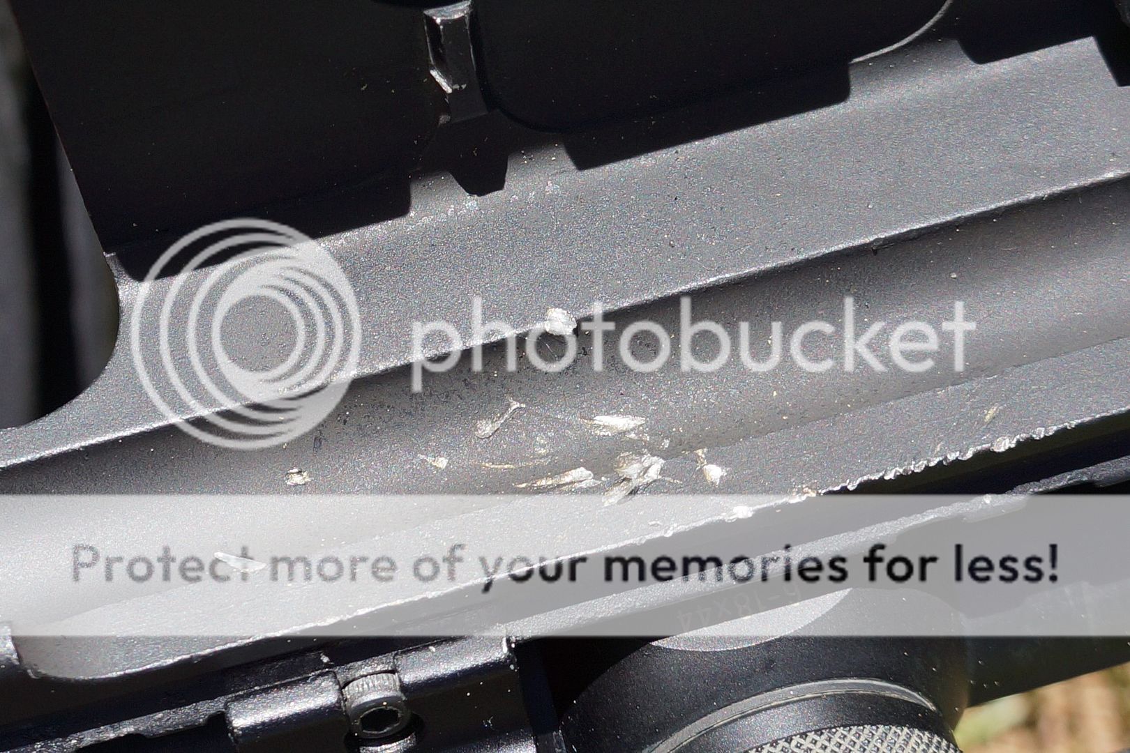

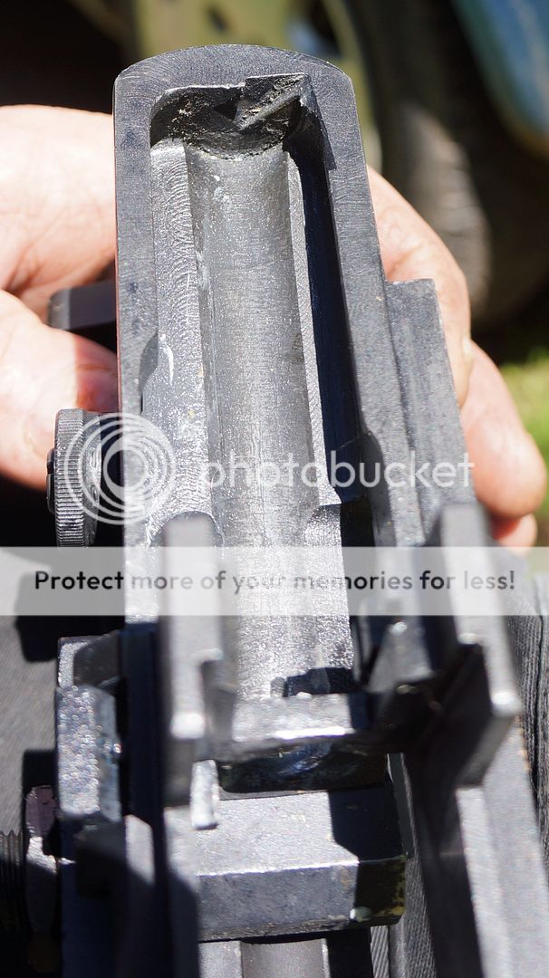

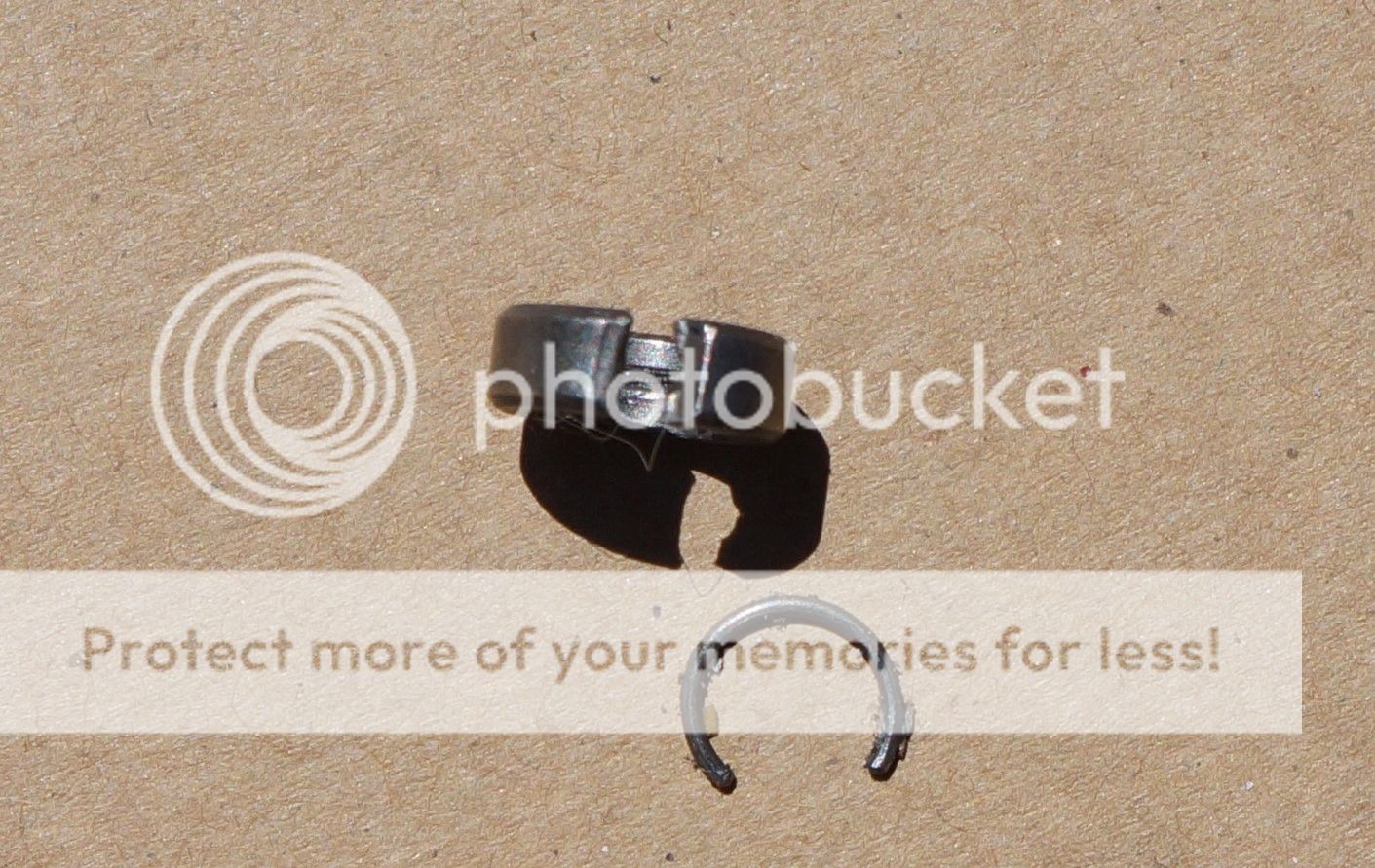

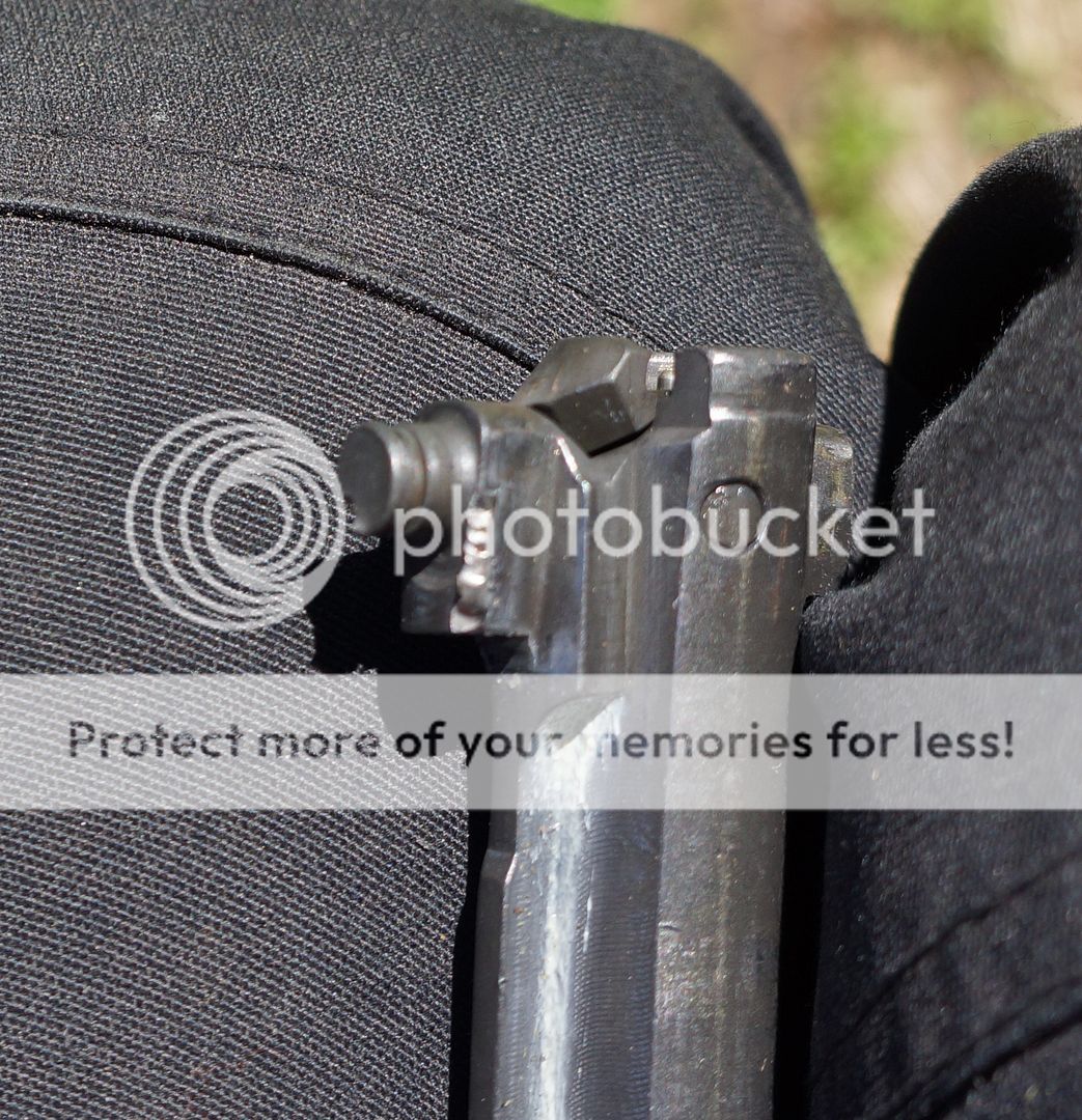

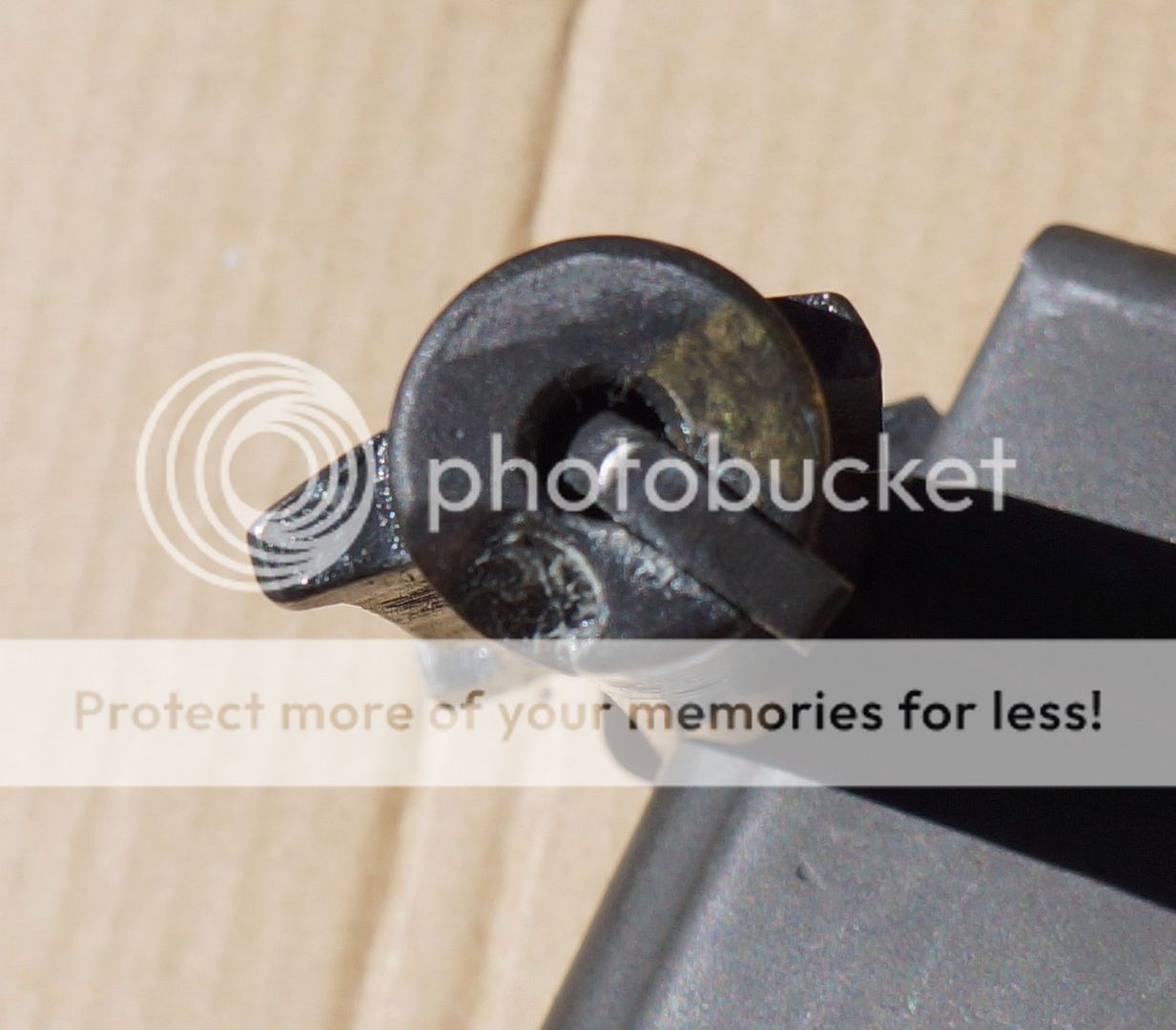

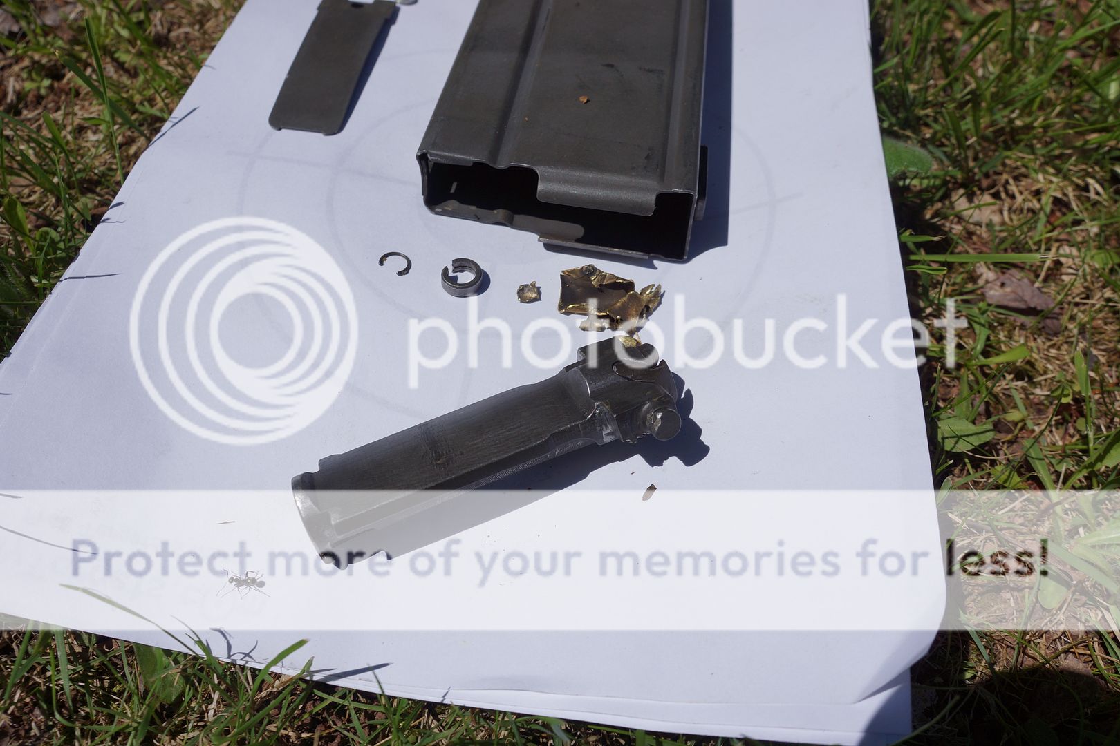

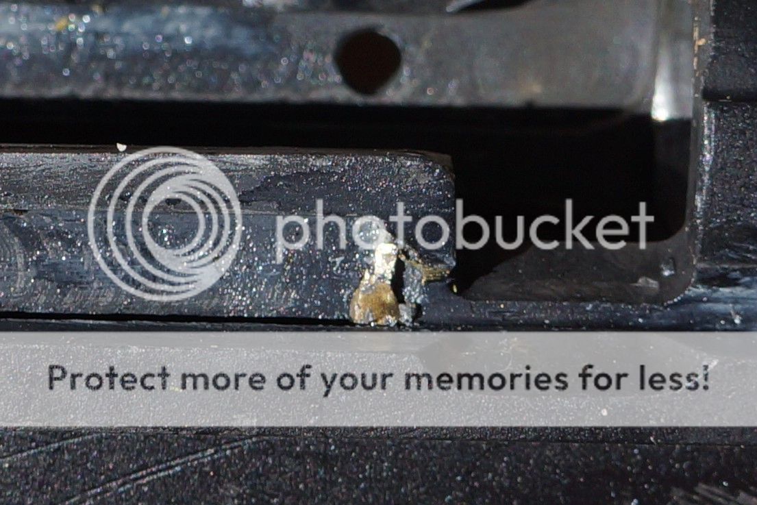

Got my "PING" going for all the wrong reasons.
Meh ........... I still had a great day out at the range :)
Just want to make absolutely clear to all, my confidence in the " POS Norc " has not been dented.
This was down to ME, not the gun. The gun did exactly what it was supposed to do and directed the energy down the mag well away from me. Gotta love that safety feature.
Going to fix her up and have at it again, tho I might steer away from the Federal primers LOL.
Having said that, this is the first problem I've had and I'm inclined to think I didn't seat one deep enough. 1 in 500+...it was me not the primer.
Life's far too short to take it seriously..............so take a chance and have fun eh.
Just don't hurt anyone on the way :)
Might end up getting one of those fancy USGI bolts yet LMFAO...unless anybody wants to sell a Norc bolt :)

sounds like a high primer or temporarily stuck firing pin but we can all guess till the stars fall from the sky LOL
good thing yer okay and yer rifle's safety mechanisms did exactly what they should have and blown straight down.

Posted the pics because I was always one of those guys who thought it always happened to somebody else.
I checked and rechecked and still missed one.
Glasses are a MUST....always. Wish I had my ears on tho cos my ears are still ringing LOL
Replacement bolt is in the post right now ( thanks goldenbb) and the wife is even paying for it, she just wants me out of the house LOL.
Never felt the hits on my arm just saw the blood dripping off me fingers...damn blood thinners :).
Will post again when its rebuilt.
I bought a 1000 Federal primers and have used 6 packs out of the case with the one mishap. I am more than ever inclined to blame myself rather than the primer.
Still getting some CCI tho ..............just in case ( no pun intended ) LMFAO
