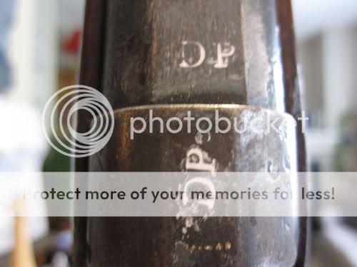

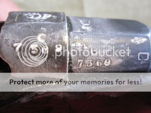

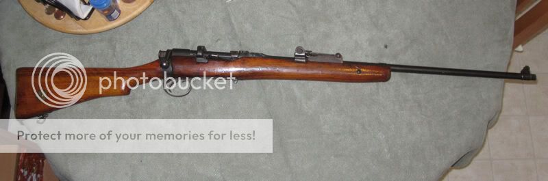

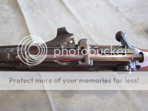

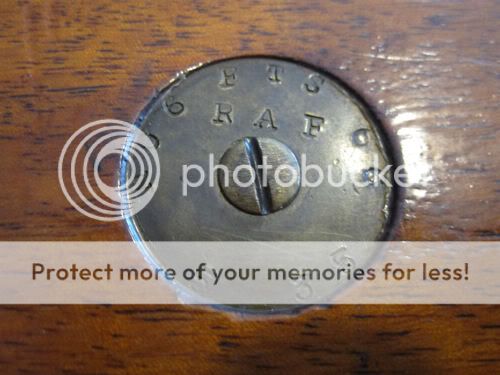

I just received my Grandfather's sportered SMLE. He got it in the early 50s in a gun trade and in it's time, it has downed a fair share of deer. My Uncle tells me it has not been fired in 15 years or so. What I do know about it is that it's a 1912 BSA No.1 MkIII, spent some time with the R.A.F., DP marked, complete volley sights, full length barrel, mag cutoff, and mismatched bolt. What I am having trouble with are the many stamps on the receiver and knox form. So, here I present some pictures for the experts out there to help me decipher my heirloom! Thanks for any new info in advance!
VERY nice and very restorable!
DP markings could be stamped on rifles for a variety of reason and did NOT necessarily mean that the rifle was unfit for use. The problem was that the DP stampings were hard to remove so, often, a DP rifle could be repaired to get rid of the DP status.... but still be DP marked.
This one has definitely seen combat use in the Great War: it had a new barrel pactically just last week (actually 1916)! Many of the chamber markings are proofmarks telling you that the rifle was tested for a cartridge case length of 2.222", a working pressure of 18.5 Imperial long tons per square inch (41,440 psi).
The butt marking disc alone is enough to give heart failure to some advanced collectors I know: May, 1935, Royal Air Force, No. 6 Fighter Squadron (I think). This would make it a Battle of France rifle also, would it not? No matter, anyway: it makes the rifle TRACEABLE to its Service career.
There will be an "HV" marking at the rear end of the back sight: "High Velocity" meaning that the sights are set for the 2440 ft/sec velocity of the Mark VII Ball round with the 174-grain composite flatbase bullet.

The rifle does in fact have the HV mark under the rear sight(which is also # matching).
