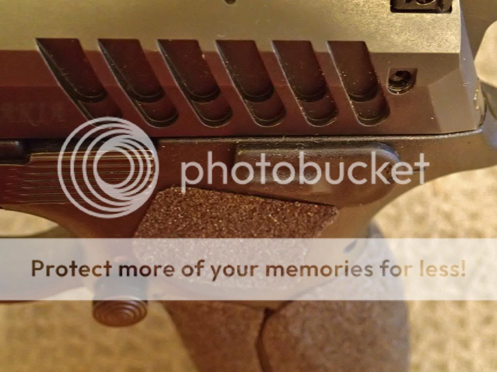

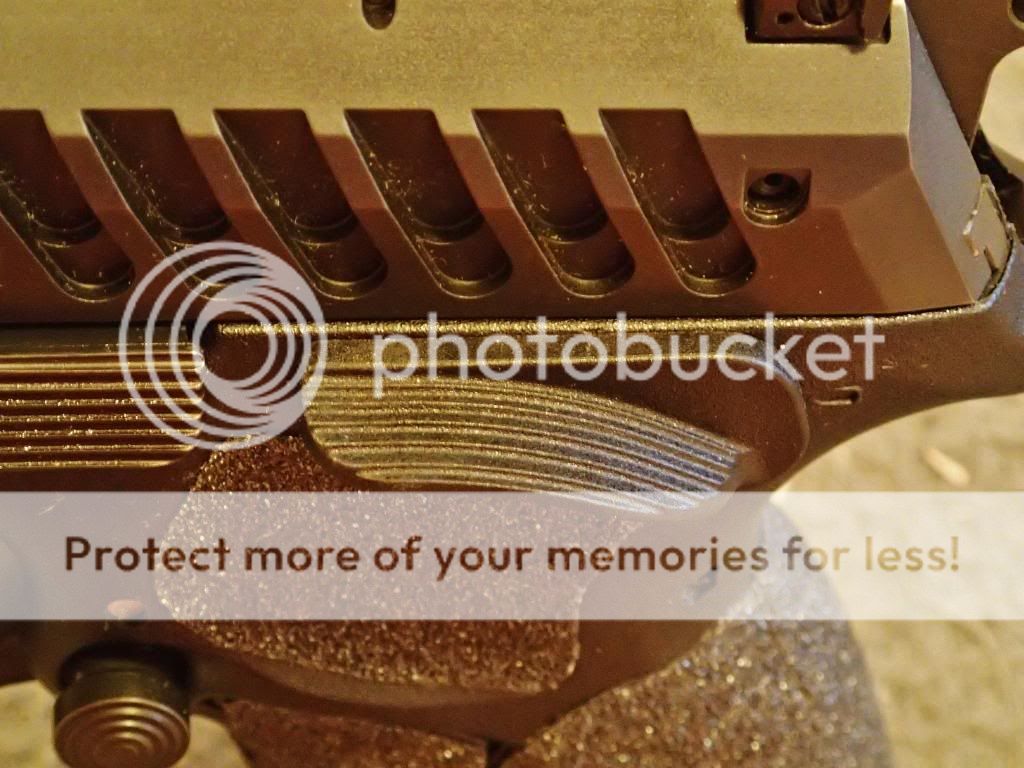

Thanks David! It's a 2 min job once you know how - lol. I do think the wide thumb safety is much easier to use, but it just interferes with my right thumb slightly and throws off my grip a bit so I'll use the narrow safety for now. I may try to re-profile the ledge of the wide thumb safety later on.
Safeties are always a matter of personal taste. I have big mitts, and with the biggest backstrap the wide safeties fit me perfectly on both sides.
I know when I sent out my team gun for a little cross T&E tour, Brennan would have preferred the thin safety on the weak side as his trigger finger could bump the safety up.
Fortunately the X-Cals come with both so you can switch or mix and match.
