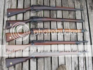

Yours is likely marked 1896 LEC1 (or 1898), I have examples where the 6 is washed out and does look like a 0 unless a closer look is taken..
Your markings will have been struck with one of these two dies
From Top is;-
1893 Lee Metford trails carbine
1895 Lee Metford Mk.I cavalry carbine
1896 Lee Enfield Mk.I cavalry carbine
1901 New Zealand carbine
