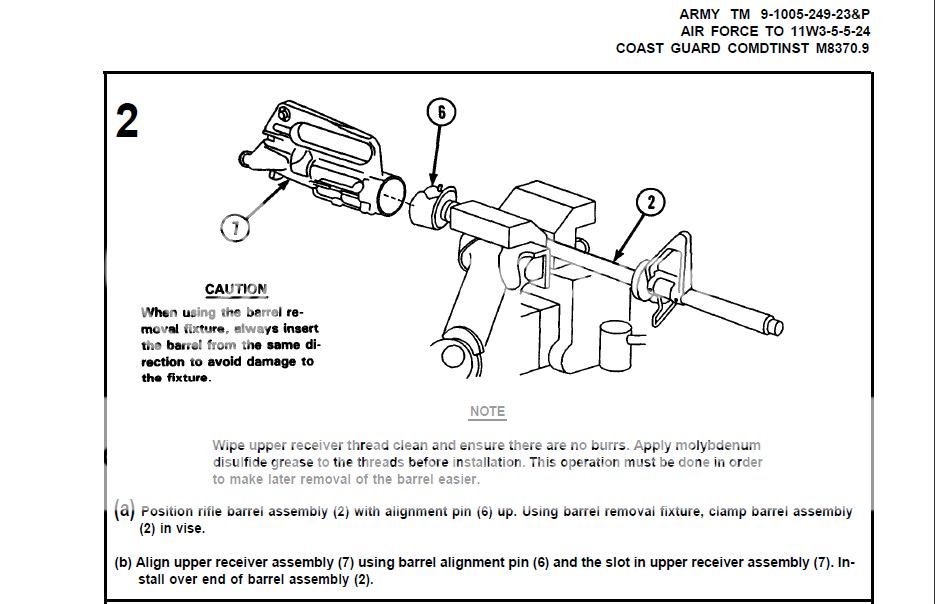

I always use a bit of Molybdenum Disulfide grease when torquing down a barrel nut. I pretty much follow the guidelines in the USGI M4/M16 armorer's manual...here's the actual instruction for using the moly grease, which is found on page 3-31 of the manual:
So it's pretty clear that the torque specs found on the following pages of the manual do incorporate the molybdenum grease.
