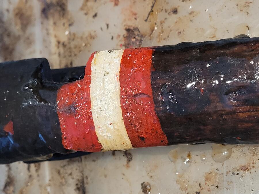

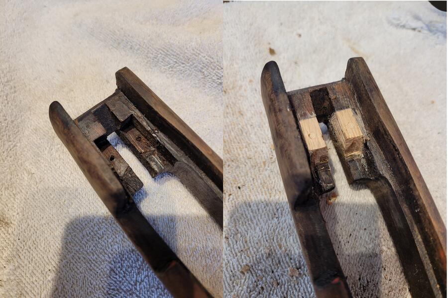

Then, wood parts are stripped of their old grime and DP paint stripes (if applicable). This allows, among other things, to better find defects – splits and cracks, stripped screw holes in the buttstock, anything requiring repair. And of particular attention: the recoil draws at the back of the forend, which will have to be in tight contact with the action’s recoil lugs when forend bedding is taken care of. Some draws come out ok as-is; most will require some shimming; others may need to be completely redone (see picture below for an extreme example that had to be rebuilt)

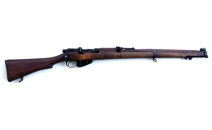

The result is a rifle as it would come to you after a Commonwealth armorer gave it a do-over. Not your average gun show parts gun
