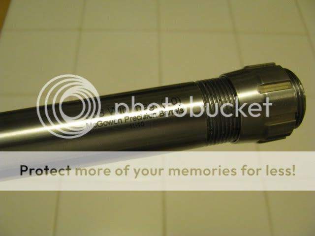

Just got in a barrel from McGowen Precision Barrels for a customer and was thrilled with the quality and workmanship.

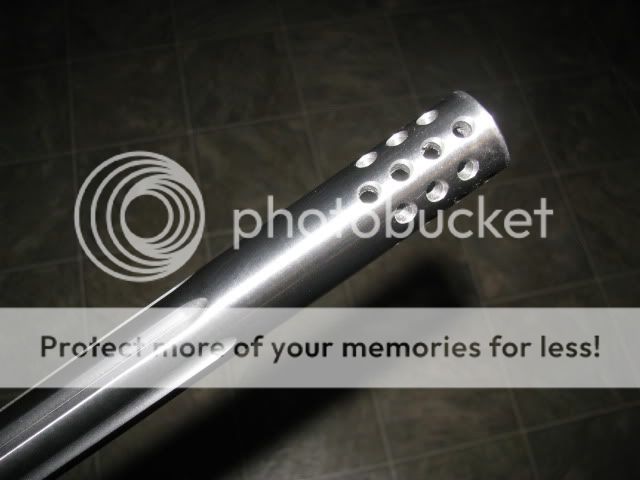

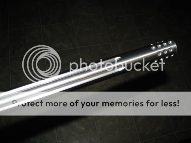

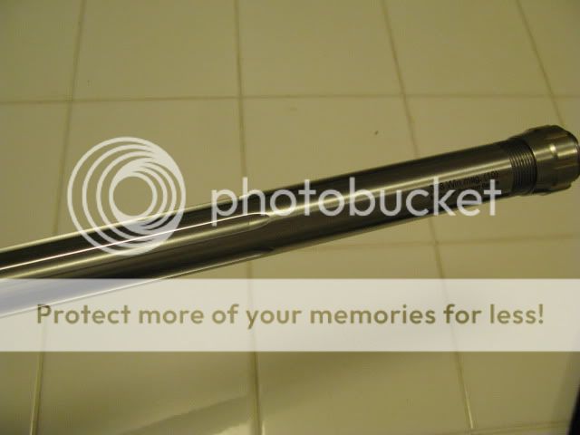

This is a prefit - chambered and threaded - for a Rem 700. Customer wanted fluting and a muzzle brake installed.

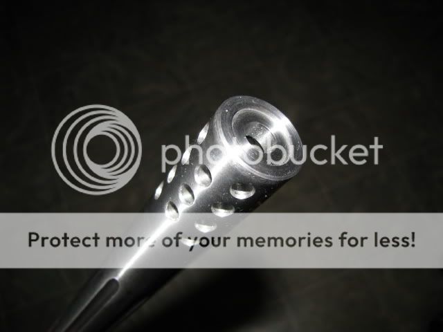

I was thrilled to see how well the machining was in the flutes and even more impressed with the brake.
All the ports are nicely chamfered and there is no visible seam on the barrel.
Threading and stenciling are also very nicely done.
The barrel nut was made by another manf.
The turnaround to get this all made was also very good (about 2 months).
Unfortunately, I will not be able to shoot the barrel but I hope the customer will let us know how it worked out.
Some of the nicest machining on a barrel I have seen....:D
Enjoy...
Jerry
